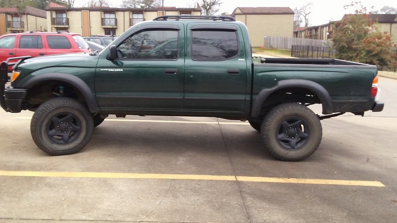

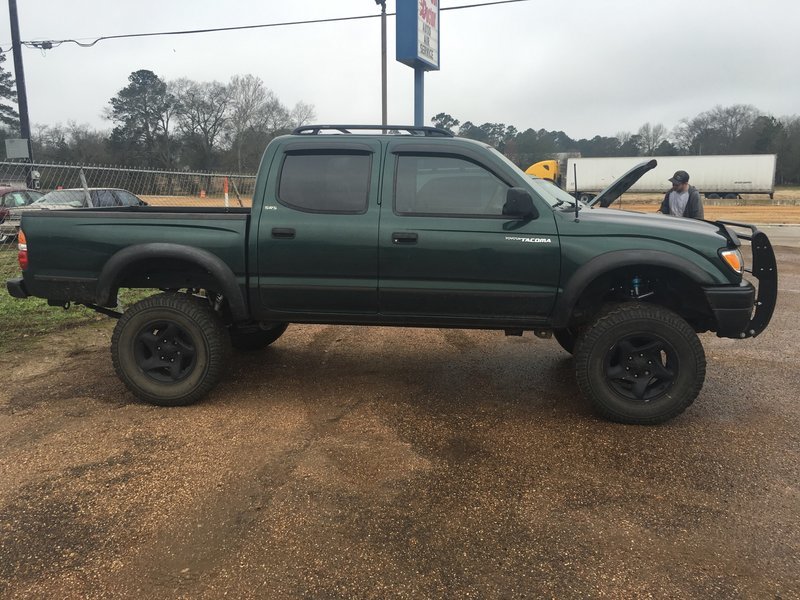

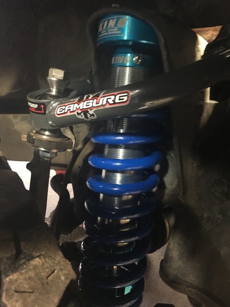

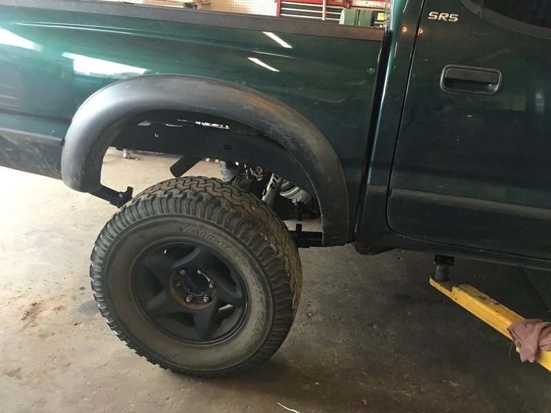

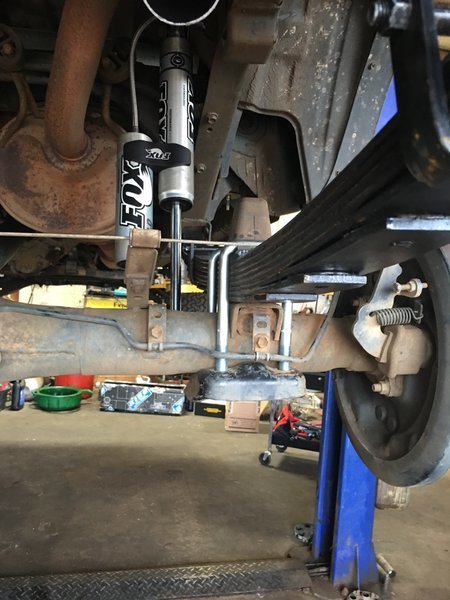

    Today 11am 40 miles later20170106_113330.jpg Yesterday 3pm 0 miles drivenIMG_6171.jpg
