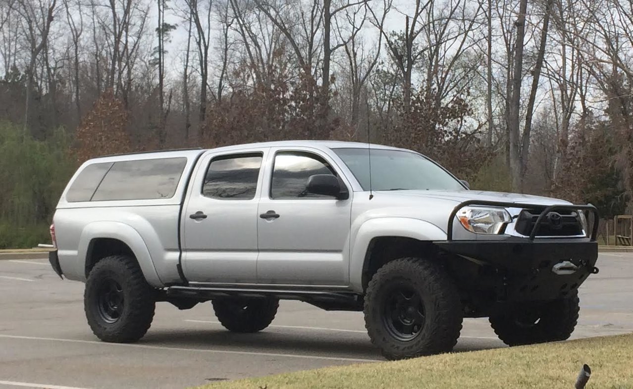

    I put the 8-leaf pack in my 2012 DCLB right after I bought the truck. Added the extra leaf last summer when I put a shell on the back. No regrets.
  13. Nov 11, 2017 at 1:13 PM
    Taco-Grinder
    Aug 14, 2016
    #194574
    6,899
    Dan
    Fond du Lac, WI
    Can we see some pictures please

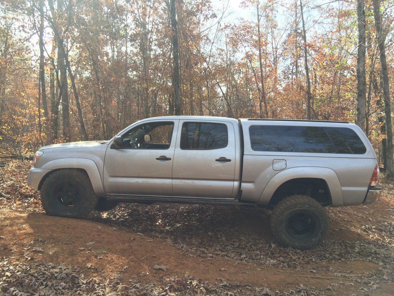

    Got some random ones on my phone. None really of the leaf pack.
  15. Nov 11, 2017 at 2:35 PM
    abqnurse80
    abqnurse80 [OP] Well-Known Member
    Mar 27, 2017
    #214544
    987
    Nic
    ABQ, NM
    2012 FJ Cruiser
    Bilstein 5100 all around, first clip front. AVS window visors, BFG AT KO2s. JBL.
    Nice, what size tires you running?
  16. Nov 11, 2017 at 4:12 PM
    #16
    suthrngent47
    suthrngent47 Well-Known Member
    Jun 3, 2016
    #188659
    110
    SC
    2012 Silver DCLB 4x4
