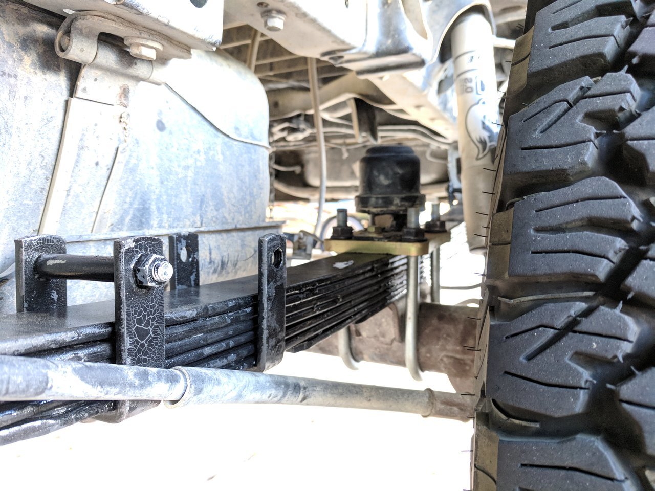

  5. Nov 13, 2017 at 10:18 AM
    #25
    Wheeler's Off-Road Inc
    Wheeler's Off-Road Inc Well-Known Member
    Mar 19, 2009
    #14922
    735
    Grants Pass, OR
    805L+1T is Driver side and 805R+1T is Passenger. :thumbsup:

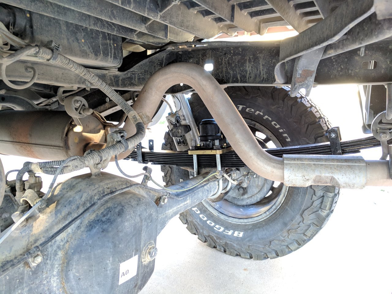

  7. Nov 13, 2017 at 2:27 PM
    #27
    abqnurse80
    abqnurse80 [OP] Well-Known Member
    Mar 27, 2017
    #214544
    987
    Nic
    ABQ, NM
    2012 FJ Cruiser
    Bilstein 5100 all around, first clip front. AVS window visors, BFG AT KO2s. JBL.
    So just finished putting them on!! I can tell already, they flex better than the dakars even when they had a leaf out!! They are pretty high, 25 inches hub to fender so hopefully these things settle a bit over the next few months!! Will report back after driving and flexing them out a bit!!

  8. Nov 13, 2017 at 2:39 PM
    #28
    abqnurse80
    Mar 27, 2017
    #214544
    987
    Nic
    ABQ, NM
    2012 FJ Cruiser
    Good thing I measured, looked at the labels after I had everything in, luckily, the driver side is 1/2 inch taller!!! :anonymous:

  10. Nov 13, 2017 at 2:48 PM
    #30
    abqnurse80
    Mar 27, 2017
    #214544
    987
    Nic
    ABQ, NM
    2012 FJ Cruiser
    So @Wheeler's Off-Road Inc , what can I expect these to settle down to?? With dakars full leaves was at 24' hub to fender, and these are an inch higher!! Is there a different shackle on the Baja edition Tacoma??
  11. Nov 13, 2017 at 2:53 PM
    #31
    Mar 19, 2009
    #14922
    735
    Grants Pass, OR
    They will settle down quite a bit. How many miles do you have on them so far? Run a tank of gas on them and see what they settle too.

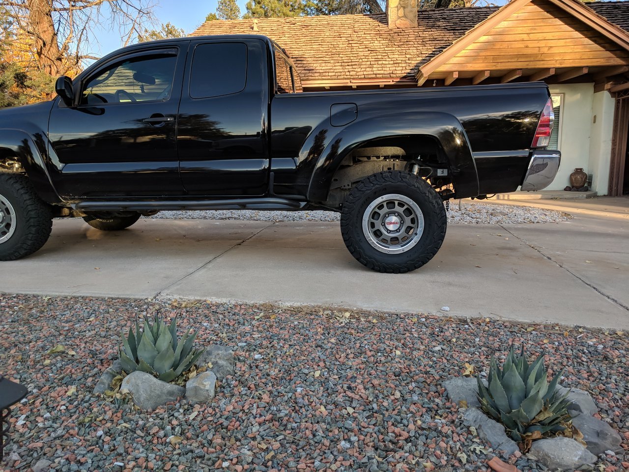

  14. Nov 14, 2017 at 3:53 PM
    #34
    abqnurse80
    Mar 27, 2017
    #214544
    987
    Nic
    ABQ, NM
    2012 FJ Cruiser
    So a few pics first is before with the dakars!! Ass is a bit high in the air, but it'll settle!! Rides like I've always wanted it to, smooth!!! Can wait to take it off road!!

  15. Nov 14, 2017 at 5:15 PM
    #35
    abqnurse80
    Mar 27, 2017
    #214544
    987
    Nic
    ABQ, NM
    2012 FJ Cruiser
    Those 265/70r16s are looking small now!!! :eek:

  17. Nov 15, 2017 at 4:57 AM
    #37
    batacoma
    batacoma Truck Wars
    Sep 14, 2017
    #229983
    11,022
    2012 Regular Cab 4spd
    Looks good that's for sure, the 8 leaf looks well constructed.
    I like the access cab, I think that's the first Baja ac I have seen. I saw a Pro ac on the forum the other day didn't know those were ever produced.
    abqnurse80[OP] likes this.
