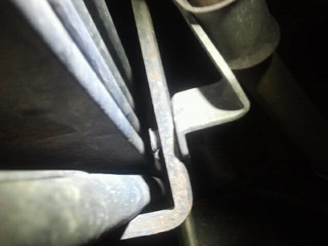

    I just installed my Wheelers AAL last week and it is squeaking and I am pretty sure it is this
    any ideas? Help would be would appreciated. The squeaking is ANNOYING!!! :mad::mad::mad:

    I cut my stock leaf retainers off because the AAL was sitting on it. It could be the cause of your squeak if the AAL is on the stock leaf retainer.

    hmm it might be? i heard it from there too.. did you fix the squeaking? or did you just say screw it and let it squeak?
    howd you cut it off?

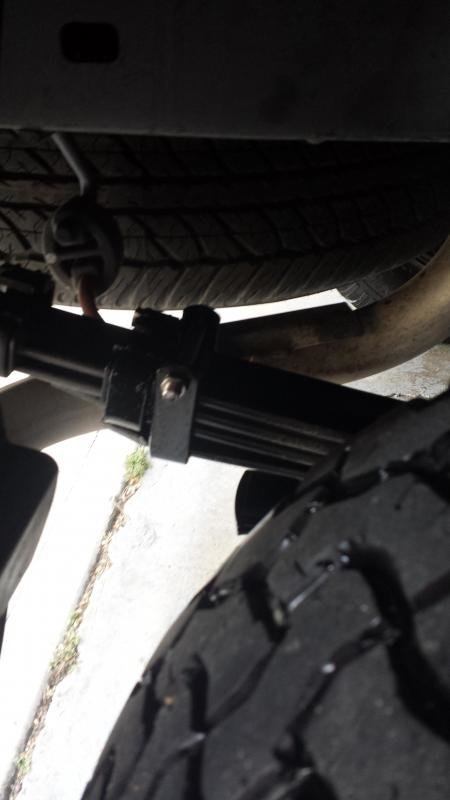

    Check the brakeline mount on the leaf springs. The bolt rubs on my aal once in a while.
