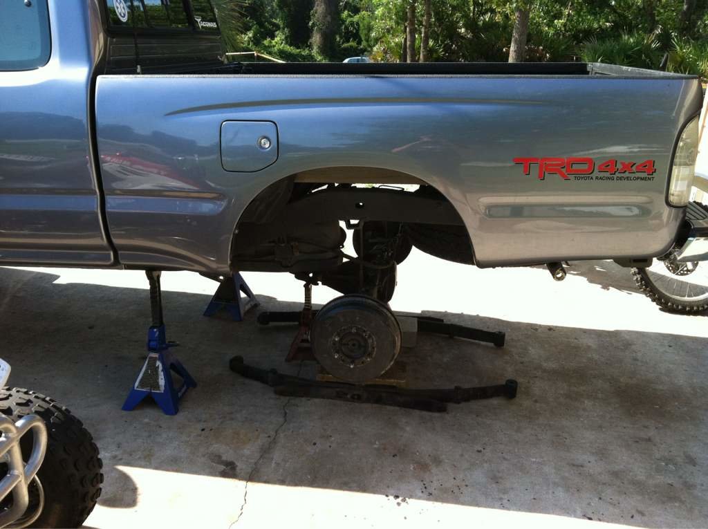

    Got everything installed. What a bitch. Especially getting the Leafs off the stock shackles. The ride is definitely better. Prior to the install, rear measurements from center of fender to center hub 19.5. Now sitting at 22.25 with a campershell. Very pleased with the results.

    Nice!! I had a helluva time with gettin the old leafs off too, moreso the main eye bolt though, had to cut them both.
    Thats a good amount of gain! must have to do w/ that you have a Reg cab, idk

    Yeah, I had to cut the eyes off too. Hardest part was getting the old bushings off the shackle. Cut most off it off and wire brushed the rest. I couldn't be happier with the springs and 5100s. Night and day difference between stock. Don't know what to do for the front yet. I have some rake but not a ton. I'm leaning toward an adjustable coilover because I only need around an 1" of lift in the front. What would be a good option? Under 1000.00.

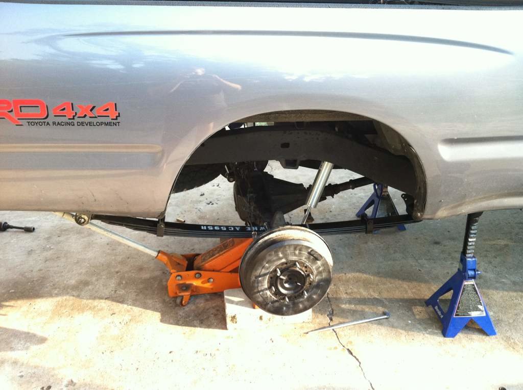

    Finally got everything on today. Only about 3 hours of actual work...did a lot of screwing around too. And thank god for Florida!! Not one drop of penetrant needed anywhere :D
    And it rides 100000000x better. Already hit some
    Trails today, and the rear was SMOOTH!!!
    No more hopping or jumpyness.
    I installed them without the overload so I wouldnt get too much lift. Because I already have shackles and didn't want more than 2" or so of lift. I gained about 3/4" overall.
