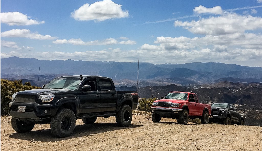

    Found this screenshot on my laptop that I rarely use, lol. They grow up so fast :oops:
    @digitaLbraVo and I think that's Alex @MADSTEEZE behind me, probably his first time hitting a trail other than Azusa and look at him now, lol. This was Rowher circa April or May of 2016...couple months after I got my truck, all stock.

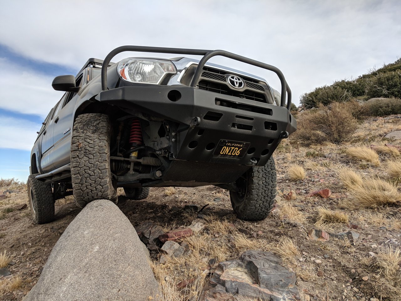

    Thanks to @eon_blue and @uhplifted
    I had a great time running White Mountain yesterday.
    Many thanks to @uhplifted for riding shotgun and getting us back down the mountain after I started puking up everything after the run.
    Same thanks goes to @eon_blue @uhplifted for getting my tires aired up while I crashed in the cab.
    And of course its going to rain/snow up there this week :)
    Looking forward to wheeling with you guys again.
