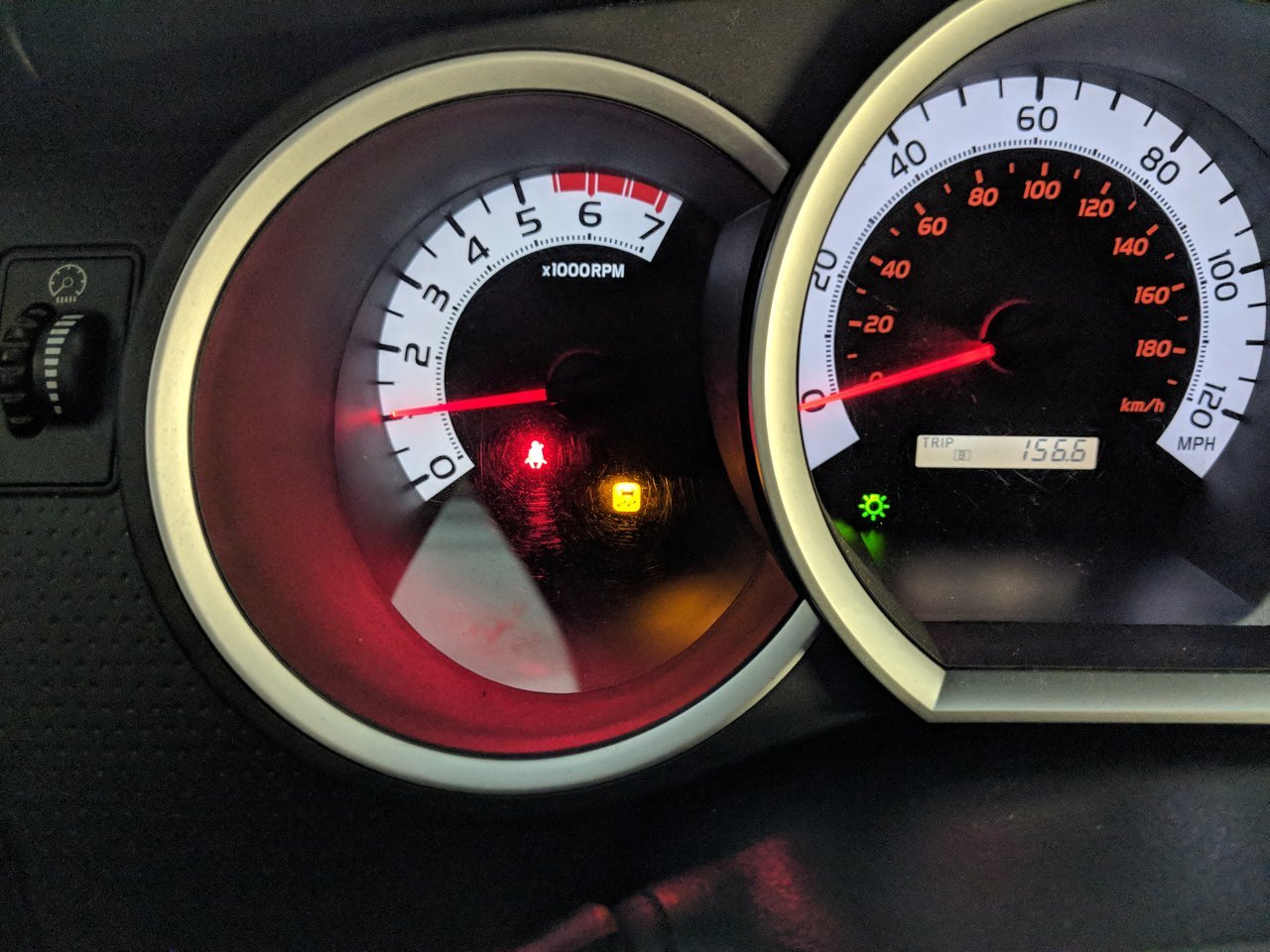

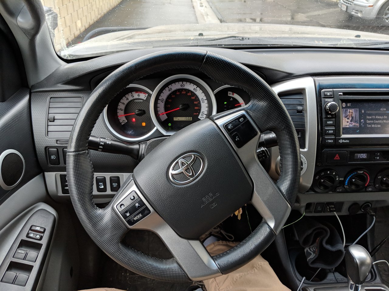

    Shouldnt be a big deal. Mine comes on everytime i mess with the front suspension or jab a rock like you did. I havent cleared the code for 3 months.

    Went to get an alignment today and its not very good news.
    Spindle on the passenger side is bent.
    They think the LCA may also be bent and bushings are worn on both driver and passenger side LCAs.
    Rack and pinion bushings are worn.
    LCA bushings being worn out probably explains the clunk I was getting for the past few months when I would hit a bump while turning.
