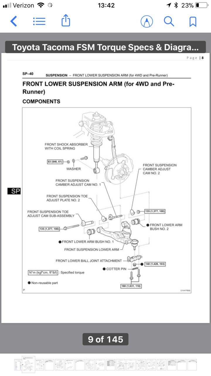

    Hey guys, hoping for some insight on this. I just replaced my stock LCA's with the dirt kings stock length LCA's. Took it this morning to get an alignment done and the drive to work felt a little weird but wasn't sure if it was cause i've been driving with an f'd up alignment for so long.
    Took it out to the dirt during lunch to check it out and the ride up front is stiff as all hell almost like if my shocks were seized up but they were fine yesterday and had them rebuilt by DSM about 6 months ago. There's a small oil spot under the coils on the driver shock but that's it.
    i tried bouncing the front end with my body weight and it barely budges.
    eccracer104 and BandanaBerg like this.

    Is something bound up, like bushings or uniballs over tightened?

    uniball to the spindle i torqued to Dirt kings spec....150ftlbs which i thought was pretty high. bolts on the alignment tabs im nut sure if the shop over tightened, I'll have to check all that when i get home.

    150 sounds high, but then again it's a lower control arm uniball and I have zero experience with that. It wasn't one of those things where they say tighten to 150 to seat and then loosen to 115 or anything like that right?
    @glorifiedwelder or @Speed Freek any experience with the lower control arm uniball torque spec for stock length dirt king lowers?
    Or what could be causing them to bind up, or act in such a way that the suspension can't cycle.

    na nothing like that, bolt to the spindle were 160ftlbs and uniball @ 150ftlbs, didn't mention anything about loosing them after seating. I'm trying to find the instruction online just to triple check.

    For reference...

    The torque on the uniballs is fine. It isn’t causing your problem. I doubt it’s the cam tabs either. But torque on those is 155 ft*lbs. without seeing the truck it’s a tough call. Jumping on the front won’t really tell anything. My front end is pretty soft but doesn’t move much under my own weight.
    I can say that back when I was mid travel I had the same lower control arms and my suspension felt much different up front with the DK lowers. Partially due to the added rigidity of the arms and partially due to the much stiffer delrin bushings.

    lol ya i pulled that up yesterday after i read the 150 on the instructions! :fistbump:

    that would make sense when compared to the soft bushing on the stock LCA's.....and the fact that mine were toast too! guess i'll recheck the torque on everything and go from there.
