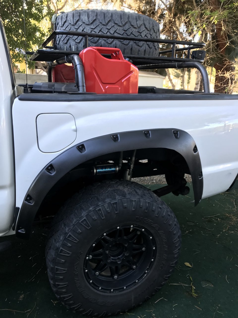

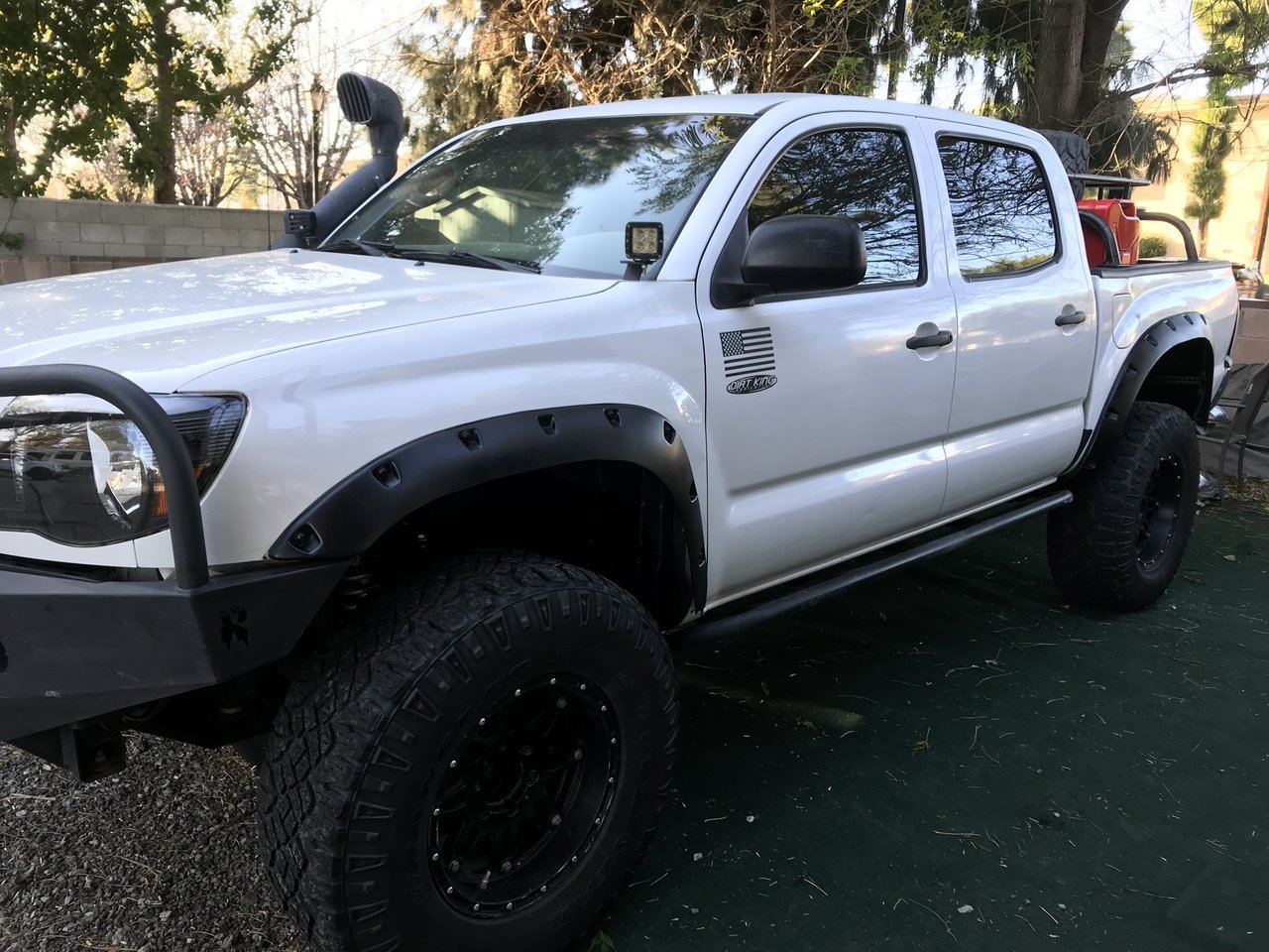

    For everyone making fun of my fender flares last weekend. Suck it. Problem has been fixed. Rhino lined them today.

    Haha yeah $50 bucks in paint wasted but whatever. At least I tired.

    You should have gone with sensitive pink fender flares to match your Rosie cheeks.
    Also, you really should of linex them. :anonymous:
    They look good.:thumbsup:
