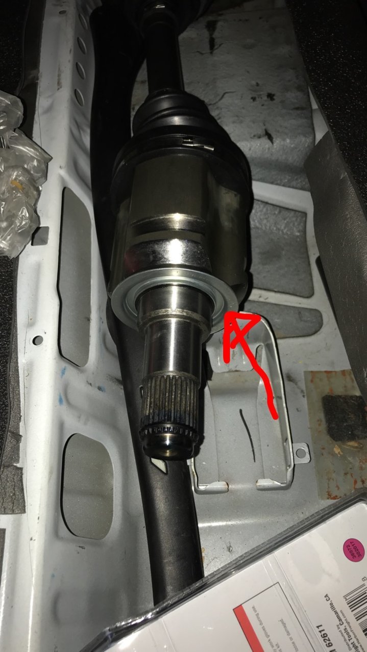

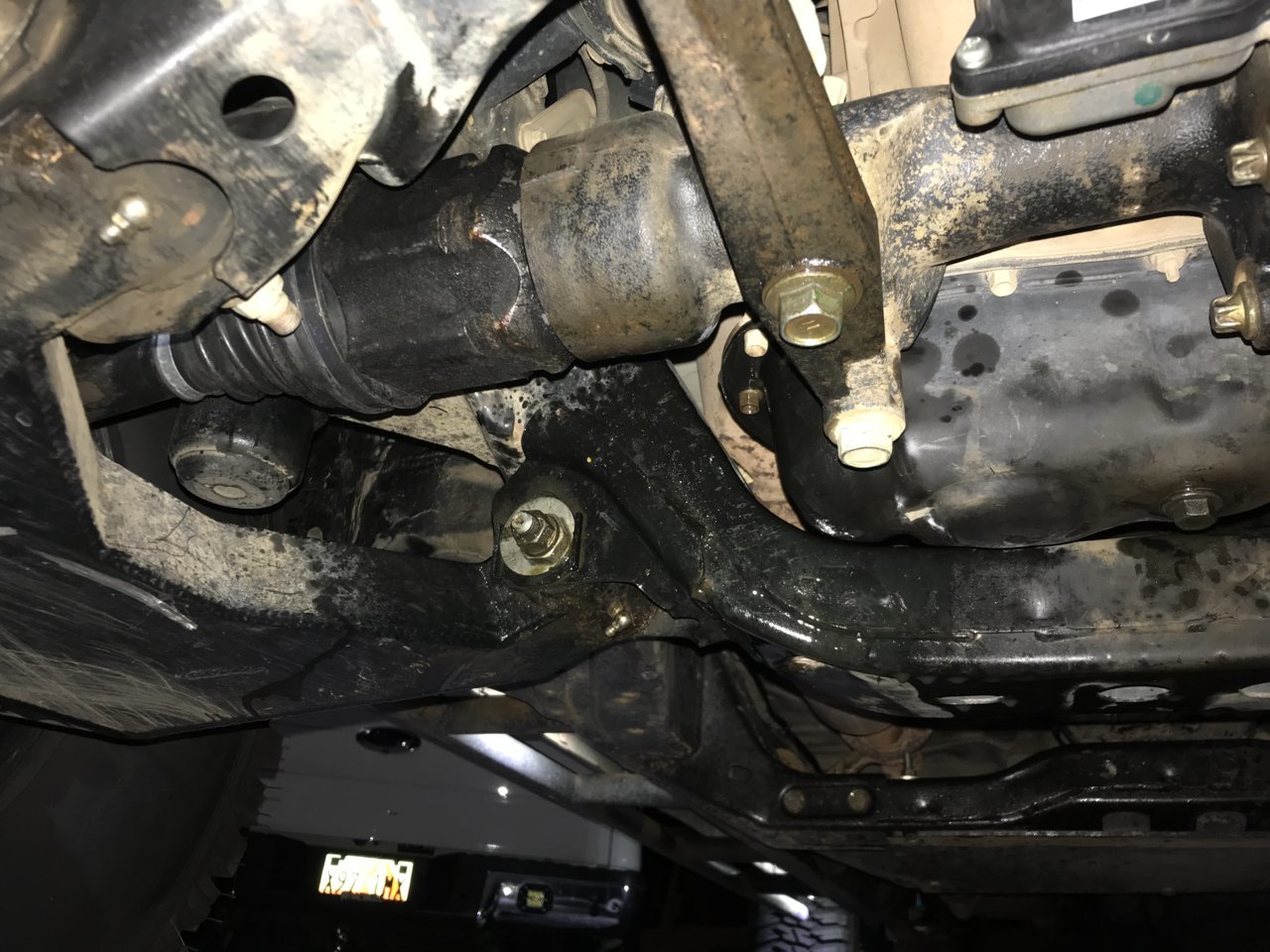

    Nope. I’m out. No Utah trip for me. Just rolled under the truck to check on things. Gear oil everywhere. Something in the front diff is leaking like hell.
    Edit. Found the problem. One of the new axles I put it, is missing this seal. My spare now has to be thrown in the truck before I go now...

    Looks like it's coming out along the CV based on where the oil is covering

    Yep. Just edited my first post. Looks like I’ll be changing a CV tomorrow all g with everything else I gotta do.
