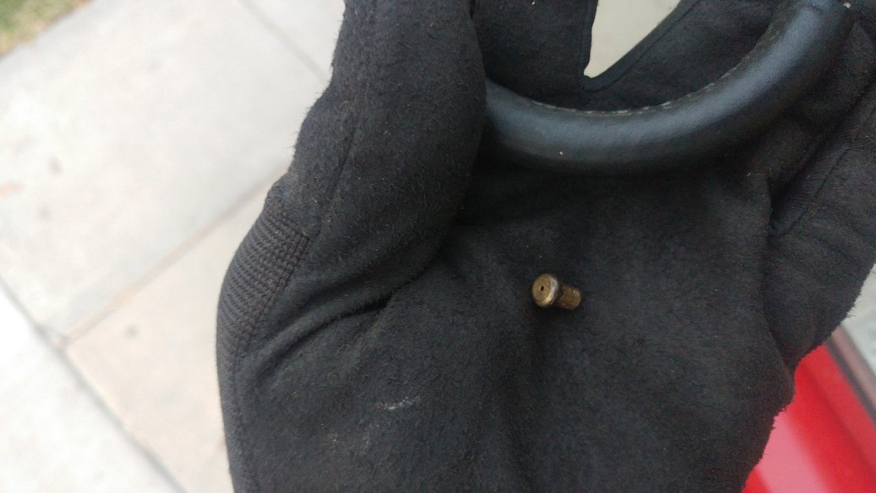

    So...I just discovered that the brass fitting from my bypass valve was sucked out and lodged in the vacuum line, probably since I got the truck 2 years ago. Took it out and it feels like my supercharged 3.4l finally got supercharged, fuck me.

    How did you manage to find that???

    It was mentioned in passing in the 'what did you do to your 1st gen today' thread...another guy just put a blower on his 3.4l and was describing many of the same issues I've had with mine since I got the truck...lack of boost in 1st - 2nd gear, boost coming on slowly and not to full 6psi throughout the other gears in WOT, pinging issues, etc. Someone casually mentioned checking the brass fitting on the bypass valve and I'll be damned if that wasn't what I needed to read all along....I've tried a hundred other different things that were suggested to me but no one ever mentioned that before

    Oh yeah I’ve seen that before. Keeps the supercharger like a toyota still. Good find. Think they do something like that to the second gens too.

    You need to watch the 2nd Gen S/C thread we discovered that months ago. However some guys have had mixed results and have put them back in.
    I would definitely get an AFR gauge before running w/o the restrictor jet though.

    Yeah it's on the short list. I'm still pinging though under WOT in higher gear so I think I'm still a little lean if anything....need to tune the 7th injector

    Can the 1st gen be boost referenced in regards to the fuel pressure regulator?

    I googled and looks like it can.
    There should be a vacuum line going from the FPR to the intake.
    You want to disconnect it from the intake and hook it to the boost port on the supercharger.
    Since you already have a boost gauge you would need a T connector to do this.
    By doing this you are now changing the fuel pressure regulator so it delivers more fuel as boost increases.

    But again ... AFR gauge first.
