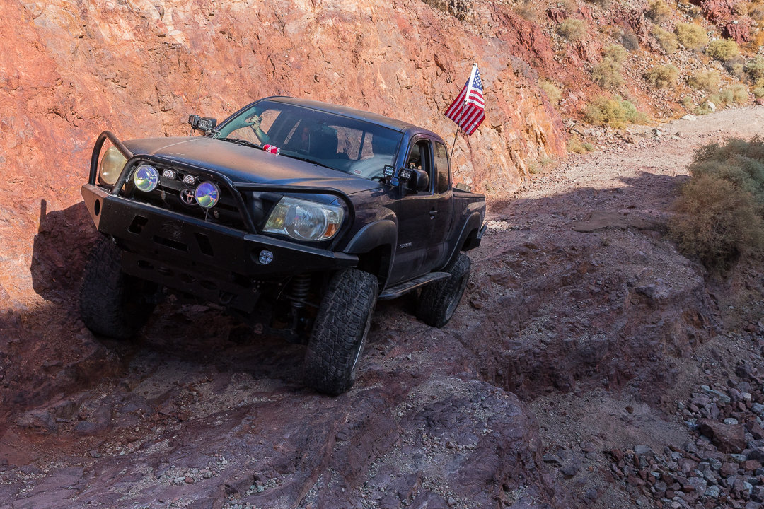

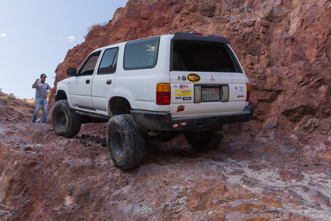

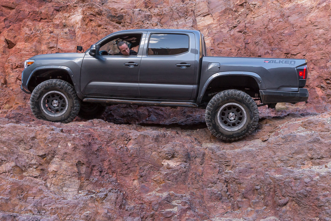

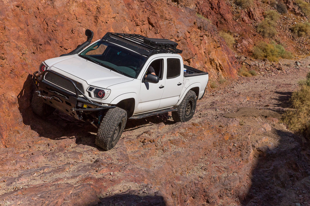

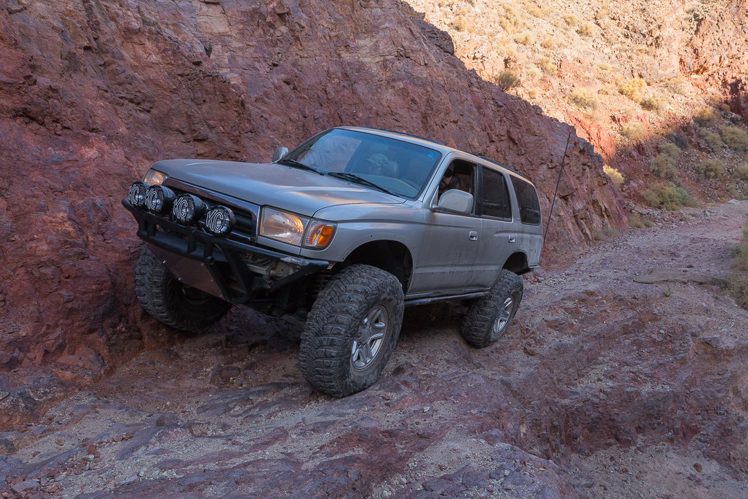

    Most trucks won't have an issue, the 4Runners don't have any problem, though some of their tires look like they are ready to go into a small slide based on how their sidewalls look.
    The last photo is the only one I got where its at its worst for 2nd gens, my driver side would be even further :bananadead:
    I would have got a better one of Mike, but he was the first one across and I couldn't not stare and think "FUCK THIS" while Kyle was spotting him.

    I think it's worse with a longer wheel base since the rear end arcs closer to the ledge. With a shorter wheel base you can keep the rear closer to the wall before, during, and at the end of working the passenger front tire around the corner.

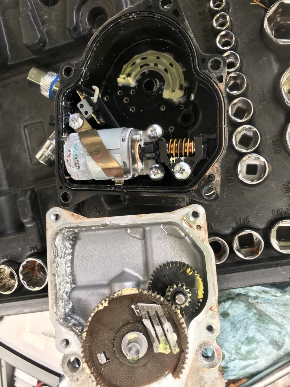

    The problem seems to be my add tube and actuator . The actuator is beeping...??? Hoorble sqeek and grinding going on when the truck is moving.

    Maybe put your truck on jackstands in 4HI and start spinning shit and see where the noises are coming from. Sounds weird, I think with people that have ADD issues it just doesn't do anything at all

    ADD tube or actuator is shot. Put the front on jack stands, Pulled the rear drive shaft and ran it in 4 wheel drive and the front tires don’t spin. Engaged my front locker and the driver tire spins just fine. And no noises. So the front diff, t case and cvs are fine. ADD Axle tube is shot or the actuator. Which really sucks cause the actuator was replaced in AUG 2017. So not even a year outta this one. Yes bought new OEM from Toyota. Time for a FJ non disconnect tube.

    Pulled the actuator. Lost half my brand new fluid. Opened up the actuator. Look at the corrosion and the water sitting I. The housing. This was new 8 months ago...
