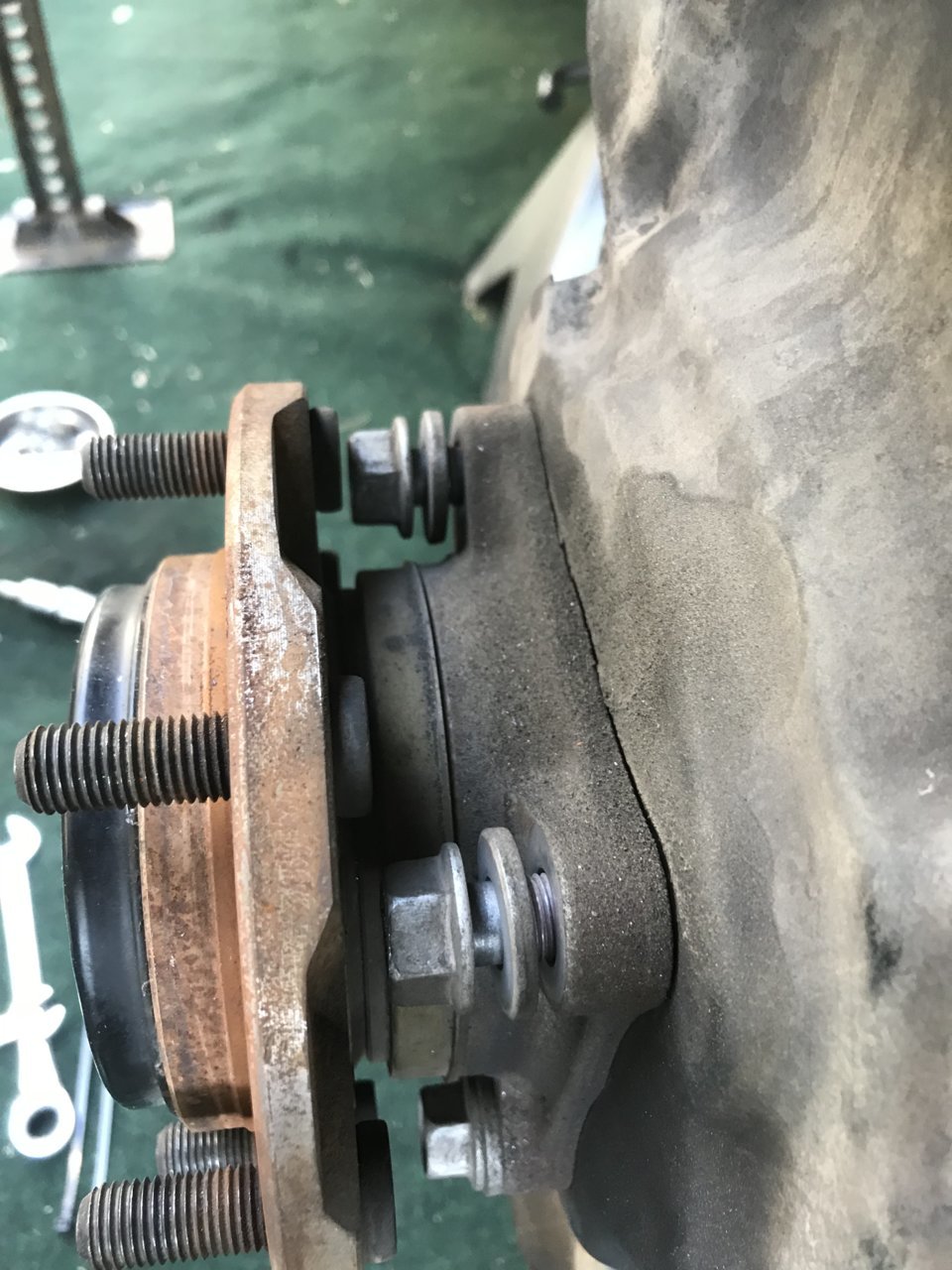

    Ditched work early today. Got home and decided to dig into the truck. I was headed down the right path with the wheel bearing issue. Found the problem.... yes. Shit has been lock tighted and torqued and marked. Also did the driver side. I’m a moron.

    Was it like that before you took it apart?

    Yeah the top two bolts came loose. Bottom two were still torque. There was hardly any play with the top two loose. They are still just fine. My pride is more hurt.

    Yeah I probably should have checked the shit after the 500 miles break in on the gears.

    Glad you caught that. Might have turned into our 3rd gen buddy who lost an axle

    Nah, I got close to that level of stupid but not quite there. At least I stopped driving my truck immediately when it started making a new sound I couldn’t identify that I knew wasn’t right. The cv axle total would hold it in right? Those don’t just pop out. Hahahaha that could have been bad.

    Saw another report of someone having theirs get loose, so you aren't the only one. Your bearings are most likely OK.

    The loose bolts would probably rattle out all the way. Once in 4x the tire would try to walk away looking like the guys that break spindles. Worst case scenario.

    Yeah the bottom two were still tight. I regreased the bearings and everything was still tight so meh, it’s fine. They are a wear and tear item anyways so at worse I took a little life out of it.
