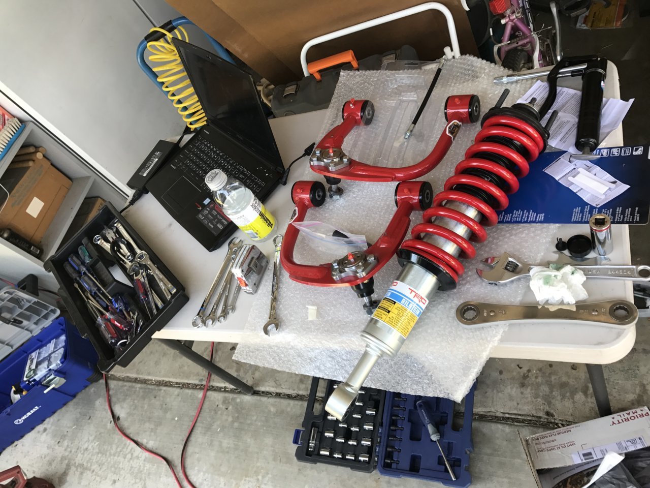

    Tackled the front suspension yesterday. Complete success with exception of the bushings still needing to be greased. It may be just a tad higher in the front until I get my leafs and hangers installed. Can't wait to get my wheels and tires swapped over.:yes:

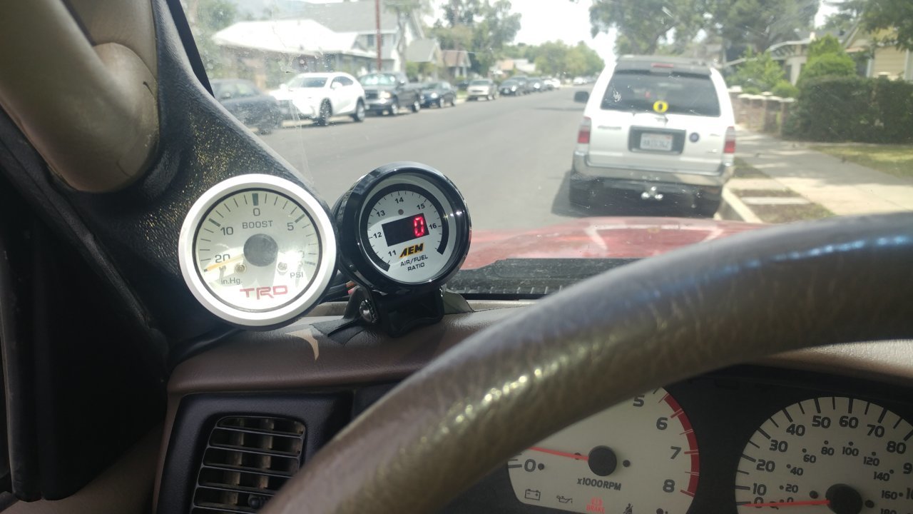

    Finally got my AFR gauge and hooked it up today...learned a thing or two about wiring in the process. Ignore the zero on the gauge, the camera phone can't keep up with the LED lights.
    Now I just need to learn how to interpret the damn thing...
    Also ignore the gaff tape mounting job lol...not sure exactly where I want to mount it yet.

    You should see 14-14.7 in closed loop and open loop will vary with tuning.

    Yeah I'm definitely seeing anywhere from 14 - 14.7 at idle or cruising...did a couple pulls in the neighborhood, got to maybe 4psi of boost and saw the numbers dip to high 12s but they jump all over so quickly it's hard to say for sure. Letting off throttle right after a pull and they shoot up to 17s then level out at mid 14s again

    Really curious to see what the numbers are entering the freeway or under load going up a grade like the Grapevine...that's where I'm still hearing the most pinging.

    When you take your foot off the throttle those numbers are normal. I’d be interested to see your wot numbers.

    Yeah I haven't really gotten the chance to try that yet, picking my gf up from the airport in Burbank later this afternoon so I should get a good chance to see those numbers then. I'll keep you posted, thanks again for welding the O2 bung for me and the exhaust chop on Friday:cheers:
    My truck is a lot quieter now without that TRD exhaust end. Not necessarily a bad thing but took some getting used to haha.

    It's normal to see AFR spike during engine breaking it leans out. I've been watching AFR/air temp/throttle and MAF sensors via Torque on the Miata lately. Trying to decide if I wanna mess with the intake. :D

    yeah I used to use my Torque App for that but my understanding is that you can't get an accurate wideband AFR reading that way...or something like that. But maybe it's different for other vehicles or N/A vehicles. It is a really good app for monitoring other readings though, I use it for my engine/air intake temps as well. Drains my phone's battery like a mofo though...
    @glorifiedwelder I did a couple WOT pulls and from what I can tell, I'm seeing high 12's at WOT on the freeway in 4th and 5th gears. In 5th I heard a bit of pinging when getting that number (RPMs were at about 2300 and climbing so they may have been a bit too low for WOT in 5th gear in that case).
    Haven't seen anything under mid 12's yet on my gauge while in boost. ~1 - 3lbs of boost or so and I'm seeing high 13s and low 14s, which is a little lean, no? I really only ever hear pinging in the higher gears at higher speeds.

    This would be rich. Air:Fuel 14.7:1 is stoich and + is more air or leaner.
    I'm not sure how Torque would be inaccurate... it's read straight off the ECU? Unless the reader was bad (giving errors) or the app isn't updating fast enough. Either way the physical graph readout is junk for that anyway. I'd run the logging and email myself the CSV for actual processing.

    ah yeah you're right, I keep switching it up thinking lean/rich goes the other way.
    Still learning how this stuff works but if I had to guess, it's based on the placement on the O2 sensor...the gauge comes with a new O2 sensor that gets installed pre-cats (after the headers) so it's reading differently than the stock sensors that are after the cats...maybe?

    but you can't read air/fuel after combustion :(

    I don't want to speculate too much without knowing for sure lol...Im sure Jason @glorifiedwelder can shine some light on this for us
