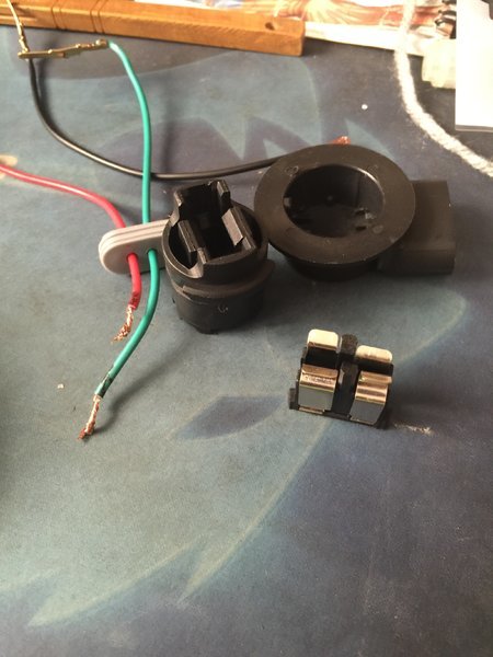

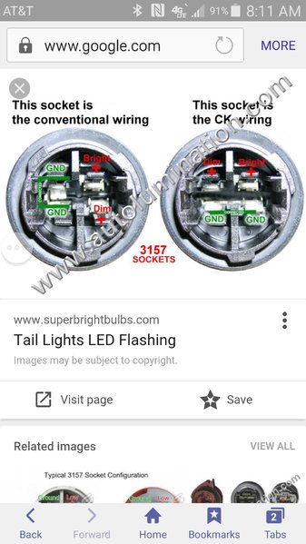

    This might help.
    The new socket needs to be hooked up differently than the old socket was.

    Hmmm that could definitely be my problem i am gonna check thx Bryan

    @TXpro4X4 yup that was it dam you dam you dam you haha now im feelin like a tweeker fckin with it

    Your welcome! :thumbsup:
    Glad i could help man.
