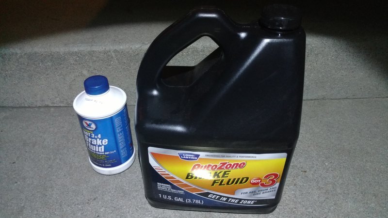

    Checked for leaks, no dripage, here's the fluid I'm using. Little bottle first, ran out, now using autozone gallon
    And yes, that's a head lamp light because it's dark! I'm. Missing something important, I'll keep researching.
    Wonder if I have to do anything with the abs...

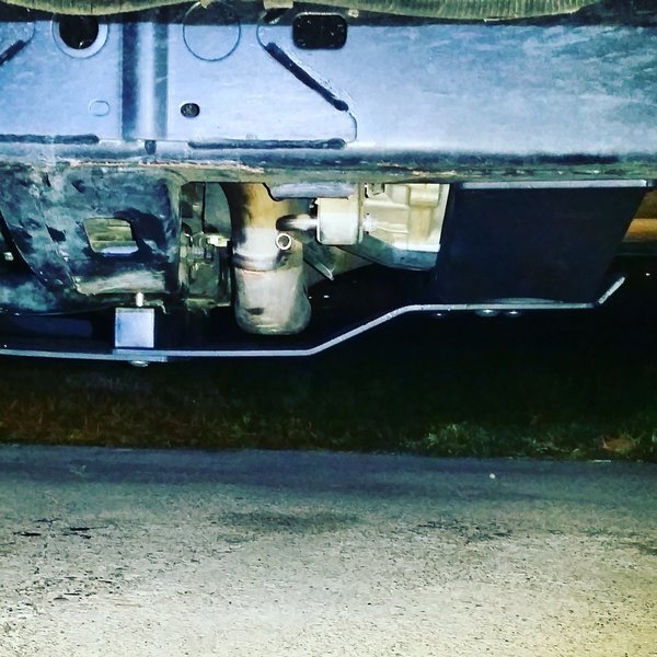

    I finally installed my skids. it was a lot of work

    So the plate covers the pipe?
  11. Oct 15, 2016 at 11:42 PM
    Z50king
    Z50king DCLBOR4X4FTW
    Jun 9, 2015
    #157056
    8,402
    Eric
    Southern California
    2016 DCLB Off Road 4x4 Super White
    Stock and loving it
    that's the stock exhaust for all v6 models now. Even the two wheel drives without the transfer case have it going way down there for no reason.
    The truck isn't even a year old so I didn't feel like having a muffler shop chopping up the exhaust to reroute it. The plate goes under the exhaust like it is shown
    TXpro4X4[QUOTED] likes this.
