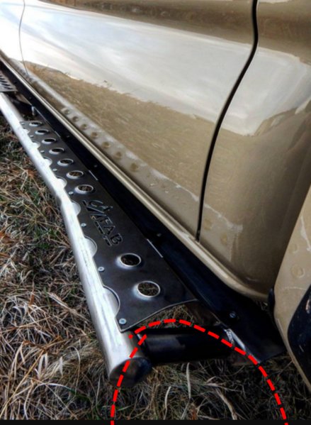

    Word. I looked at the design. Was curious of a possible rock being stuck between the rear of the slider bar and the body of the truck. Something wedged in there could prove to being an issue if needing to reverse?

    hmm, I was talking to someone in Big Bear about this exact scenario that happened to them once...a stick of wood sticking up from the ground got stuck between the slider and the body of his truck and caused some gnarly body damage. Seems like a freak accident but at the same time...not all that hard to imagine happening. The C4 sliders have fill plates though don't they? Brian's and Steve's did anyhow

    Yup happened to me. If I had no slider the wood would have glanced off and caused no damage. But it wedged and caused damage to my door and rocker. If you get sliders get the top plates.

    I'm talking about right here. A rock lands there and how does one back out? Winching backwards is always the best move. Looks like a stud holding a truck in one place with the the only option is to go forward.

    Yeah looks like a problem to me.

    A slight curvature would allow to protect a rock wedged and the ability to bump around. Things get nasty out in the wild and sometimes force and LOUD bangs are what's needed to get out. I've seen some "freak" occurrences out there. It happens more than we would imagine. Most recent was Cali Raised Ford LT on Jacoby. He was being a nice guy and pulled off to the side for downward jeeps coming by and he wedged a rock between his axel and gas tank. Not Blake's fault one iota. Theory means jack shit in the bush.
