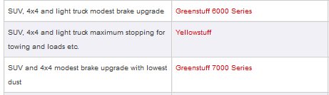

    EBC Orange is a race pad, ebc heavy duty (ironically also orange) is a heavy duty pad. Almost twice the price of green, but more geared towards a commercial application with heavy weight and frequent mellow stops and a super long life span.

    For our trucks you'd be looking at green or yellow.
    Green is for a modest improvement, yellow is the real trick one. Handles high heat very well and will stop you more quickly, but a lot of dust and less life.

    Yeah I started to find that after posting that. Looks like for us is: green > red > yellow? But they even say red works best for "Works best on heavier, higher powered hatchbacks, saloons and sedans (use YellowStuff pads for lighter hatchbacks, sports cars and compacts)" And green is a "light upgrade"

    For our trucks it's ultimax > green > yellow. the heavy duty pads kinda fit in their own category.
    Ultimax is a cheap stock replacement, nothing fancy there.
    Green has 6000 and 7000 options. 6000 is a bit softer and more dust, 7000 is a bit harder, longer lasting and less dust.
    Yellow is there most aggressive pad for heat (fade) resistance.
    From EBC's site -
