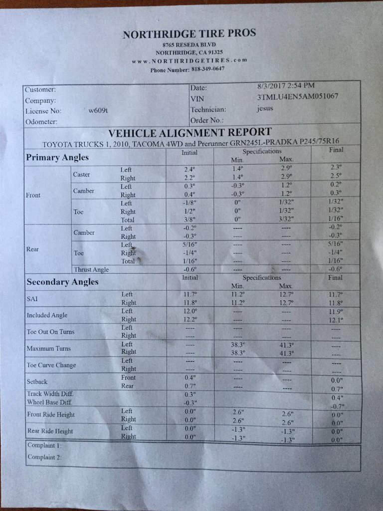

    By the way, I finally found a shop that can handle mid and long travel alignments. Northridge tirepros. 8765 Reseda, Northridge 91325. Talk to Roy, general manager, and he will assign his tech Jesus to do it. He was been aligning and installing lift kits and long travel on trucks for over 15 years. It took him 25 minutes and a test drive around the block and it was done. He nailed it. The truck is dialed and driving great.
    $130 Plus 6k mile warranty. I hinted to them that I "may" use the truck for rock crawling and beat the shit out of it - their response was to just not tell them and they will honor it.
    Pic of final specs:

    Let me know if you rub that fire wall turning under compression. I rub with castor below 2.8. But haven't been aligned properly since before my dirt king lowers. Wondering if they help push tire forward..?

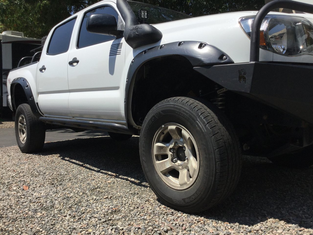

    Pic for reference and embarrassment... long story short, new tires are at my place in Utah and I had this set laying around the shop.

    Ideally you want the caster as close to 4* as you can get it on a midtravel setup

    I don't know shit about alignments... is it possible to get that much caster and st, keep everything else in spec around it?

    On 9 out of 10 trucks with a good alignment guy it is possible. The tough part is getting the alignment guy to mess with everything long enough to get those numbers. Every time you adjust one adjustment point on the lca or tie rods the other points need to be changed. Most guys just get everything in spec and call it good. I've seen the guy I use spend as long as 3 hours going back and forth moving stuff around to the specs I wanted on my front end. But I have yet to see a truck he couldn't get to a minimum of 3.75* caster.
    Edit:actually I take that back. Their was a 2016 he couldn't get past 2.4 but that was because it had a bent spindle. We swapped out spindles and he was at 4*

    If you aren't rubbing you'll be good. But if you are I'd just ask the guys that did it if they can adjust the caster. I usually tell the alignment guy what my goal numbers are prior to them doing the alignment. I think if they know you have expectations above just the standard alignment they will work a little harder to get the alignment exactly where you want it

    Yeah as close to 4 as you can get it. It's not really that critical until you start running 35's then it's almost necessary on 2nd and 3rd gens

    The specs Kyle posted are what you want for 33s. Castor 3+ is for the big boys
