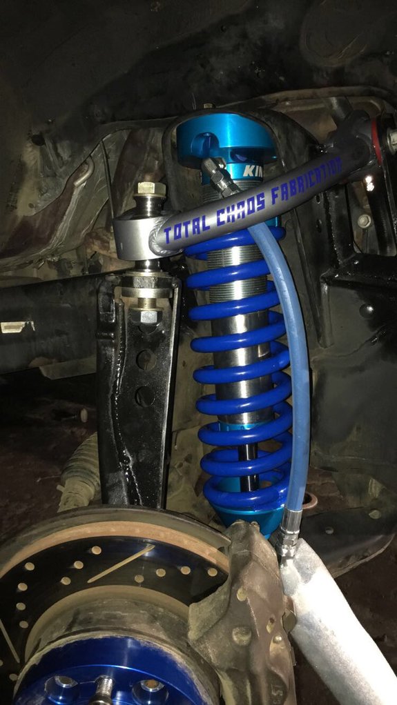

    I wish mine did. I can get like 1/10 of a turn with the T handle, then can't get to the next hole in the collar. Plus for mine at least it would be the biggest PITA to re-tighten the collar with the Allen after with the space in there :bananadead:
    Adding the resi on the first gen takes up the wiggle room to adjust on the truck I guess

    Pics are with weight on the coils but you still get the idea.. PITA:anonymous::bananadead:

    Would you believe I'm just a mall crawler? :notsure:
    That was the night I put them on. The lower pic you can see the resi is still in the foam wrapping :D
