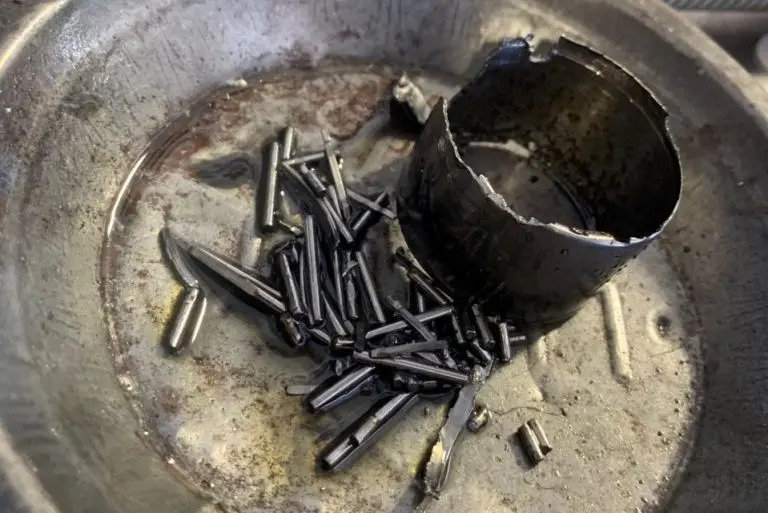

    Wait till it fails first? You really want one of those rollers breaking apart and going into the diff?

    I mean, failure usually starts with a mild vibration, not a catastrophic explosion.

    I mean, i guess. But why rip apart the front end twice if you can take care of it all at once? And stressing something with a design flaw; not something I would roll the dice with.
    My bushing was done when I lifted. And I made sure the bearing was intact upon removing to be sure there was no metal slinging around in the front diff.

    Any link to an instance of this? People change to the bushing due to noise/vibration. Haven't seen a case of the needle bearing mechanically failing.

    Not from the article author either. That whole article is full of stock photos of unknown source. No way to verify if that picture even came from a Tacoma. TW blocks the Trail Tacoma domain probably because the articles are advertisements poorly disguised as how-to articles.

    I might not be Johnny on the spot but I'm persistent. Couple posts down from the one you linked.
    https://www.tacomaworld.com/threads/front-diff-vibes-ecgs-bushing-fix.464941/page-2#post-14032222
    Also from one of the four runner forums (its relative because of the same design between the runner and tacoma).
