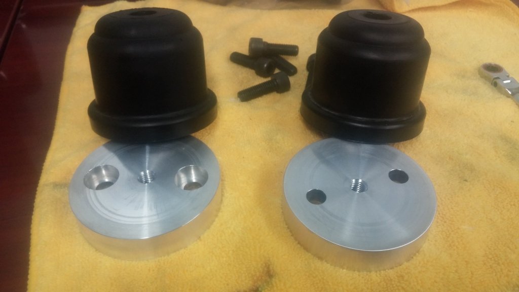

    You got any pics of your rear setup?
    I am in the process of mounting the rears and I am trying to figure out how tall of an adapter to make. I have the exact same rear configuration of ubolt flip and wheelers 3 leaf AAL. The normal wheelers mount look like it is way too tall and would unnecessarily limit travel. Any experiences you want to share would be appreciated.
    I am leaning towards a 3/4" tall puck/adapter.
    ETA: Here's my adapter, I wil install them tomorrow when my stainless fasteners show up.

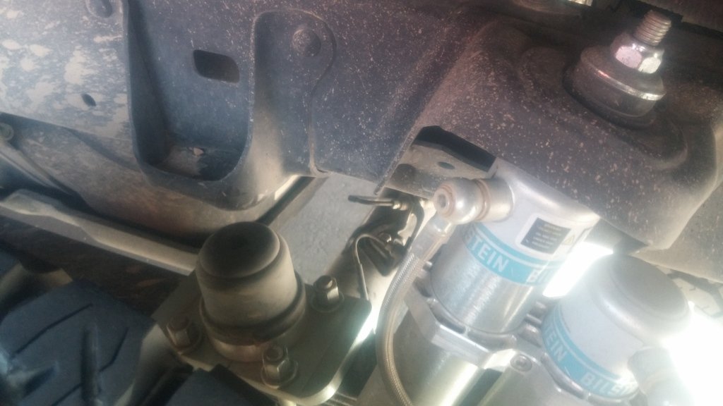

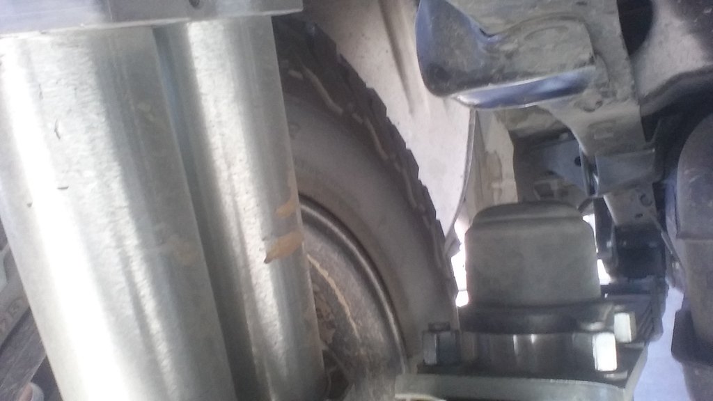

    Do you have any pics of these installed?

    Where are you installing them using those adapters?

    Sorry for the crappy cell phone pics but here ya go; disregard how dirty my truck is, I just got back from KOH and haven't cleaned it yet.
    After the week in the dessert, I am going to have to rethink my entire rear suspension. I have 6112's (at 3rd setting) in the front with superbumps and 5160's rear with wheelers 3 leaf AAL. The front is absolutely amazing in the bumps and I couldn't be happier. The rear on the other hand still hits the bumps. FWIW, I do not blame the bumps at all, they work amazing. I think the rear springs are woefully inadequate as is the wheel travel. I have about 5" of uptravel before the superbumps are fully compressed and I was still hitting them frequently. I'm not sure where I am going to start making changes first; either new springs/shocks or hydraulic bumps.

    You posted right as I was uploading pics.
    If you have any suggestions based off of what I said above about still bottoming, I am all ears.

    @Lostsheep did you verify that the shocks were not bottoming out?
