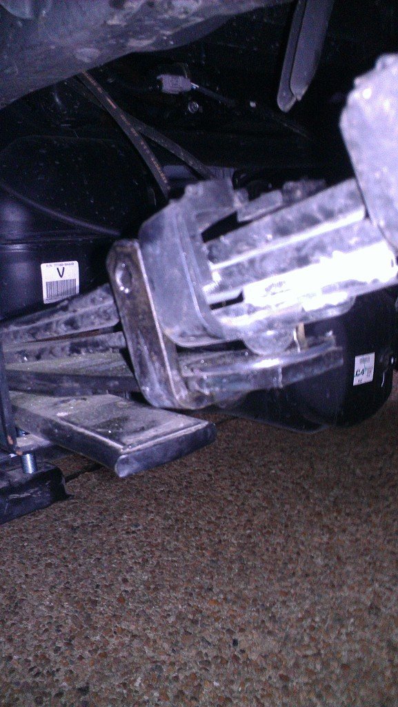

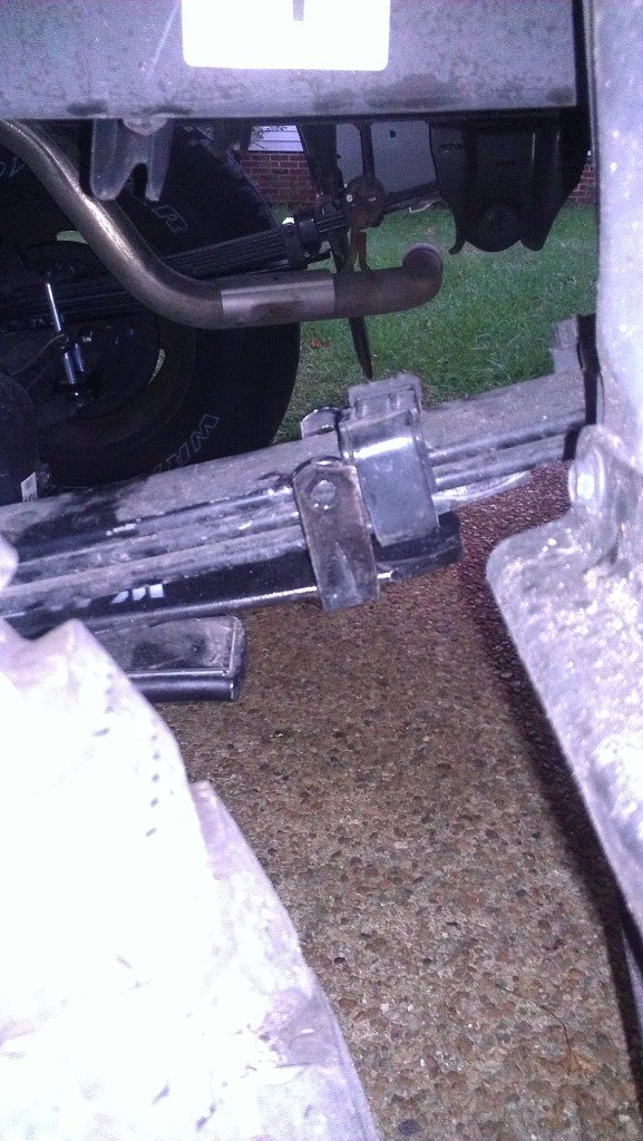

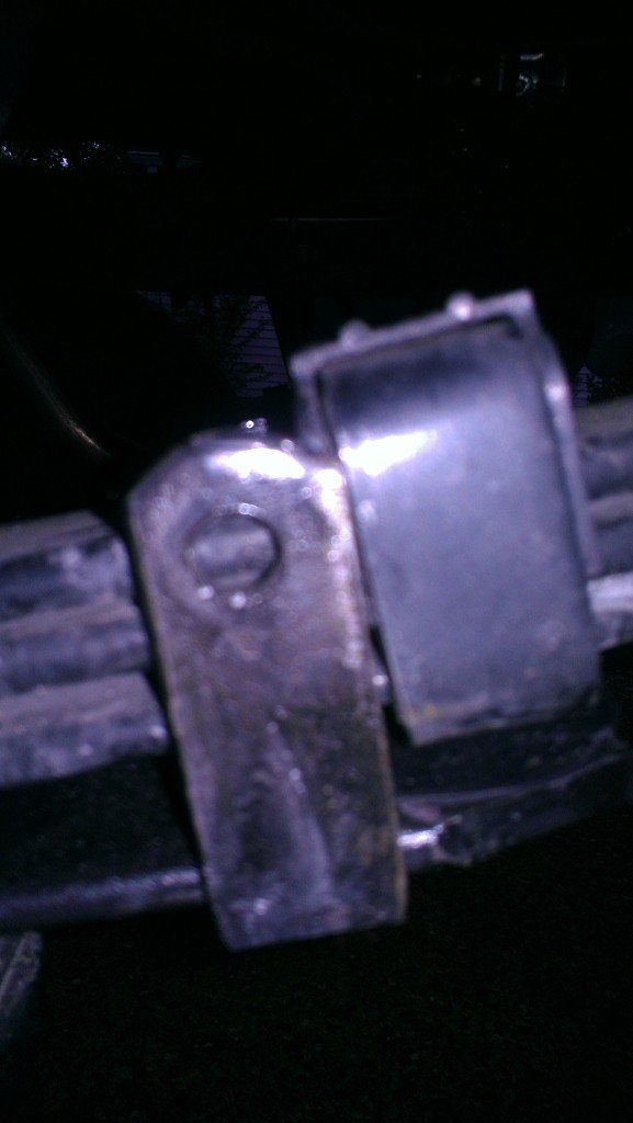

    So I just put OME 885x's w/ 5100's at 0" in the front with 5100's in the rear and the Wheelers 1.5" Progressive AAL. Got everything installed smoothly up front and then came the AAL. Install wasnt difficult but I ran into a problem. The factory leaf hanger was resting up against the new hanger for the AAL and the factory hanger was also wedged on the AAL which wasnt allowing the bolt for the new hanger to go through as seen in the pictures. Called wheelers and Dan was very helpful. He told me that some trucks for some reason which he hasn't figured out have the factory hanger in a different spot causing this issue. So he told me to grind the rivet head off the bottom of the hanger then use something like a crowbar to spread the hanger open and pull it off. Once that was done the AAL hanger popped up and the bolt went right in. Overall excellent product that rides great, great price, outstanding customer service and overall an awesome buying experience. Ive dealt with wheelers several times before and always pleased. Thanks again guys :thumbsup:
    And how the truck sits after it all...

    so would you typically run with both hangars or does the factory one come out anyway?
  7. Oct 29, 2012 at 6:01 PM
    757 Taco
    757 Taco [OP] StormTrooper
    Apr 15, 2012
    #76946
    1,425
    Tyler
    757
    2022 DCLB TRD Sport Premium 4x4 Ice Cap
    - Digital Fit WeatherTechs - Recovery Hitch Shackle - LED Map Lights - LED License Plate Bulbs - TRD License Plate Brackets - Front Recovery Shackle - Toyota Bed Mat -OEM Mudflaps -OEM Black emblem overlays - Removed front air dam - Goodyear Duratracs 265/75/16 - TRD Pro wheels
    typically you'd run both but for my application I had to ditch the factory one.

  12. Oct 29, 2012 at 6:23 PM

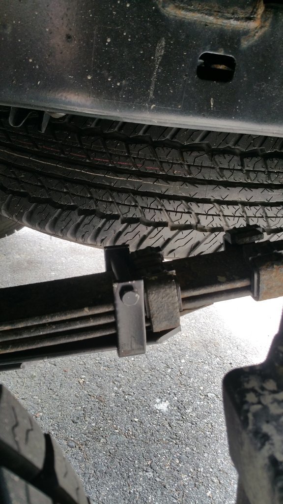

  17. Jun 27, 2017 at 8:34 AM
    #17
    Tacoman James
    Tacoman James I am Tacoman
    Jun 27, 2017
    #222507
    106
    James
    Maine
    2013 Tacoma SR5 access cab 4x4
    3" lift front Bilstien 5100s at 0 with OME 887 coils, Freedom Offroad UCAs, Bilstien 5100 rear shocks, 1.5" lift rear Wheeler's Offroad progressive AAL packs, Airlift helper airbags, N-Fab nerf bars/side steps, all sittin' on Falken 265/75/16s on American Racing 16s

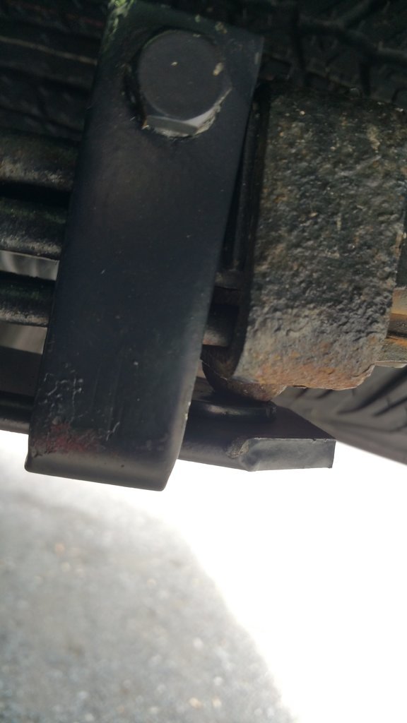

    Sorry to bring up an older post that already has a solution, also I have a 2nd Gen, But my issue is the same. I'm wondering why you must remove the factory bracket. I'll include picture's of my wheelers AAL, you'll see that the leaf rests on the rivet and the bracket on the AAL rests very close to the factory one which you've described as a problem. My ride quality is great now, no issues so far from what I can tell.
    So, what issues will occur if I don't remove the factory bracket?

  18. Jun 27, 2017 at 9:08 AM
    #18
    chucklefunkk
    chucklefunkk Well-Known Member
    Jan 1, 2017
    #206229
    462
    So. AZ
    2016 TRD OR
    I'd imagine you're running a real risk of stressing/cracking that leaf. It's sitting at an awkward angle.
    Icon instructions specifically mention removal of the stock spring clip in step #5. https://www.iconvehicledynamics.com/wp-content/uploads/2016/07/I51100_REVA.pdf
    Tectonic likes this.
  19. Jun 27, 2017 at 9:56 AM

    Understood, thank you.

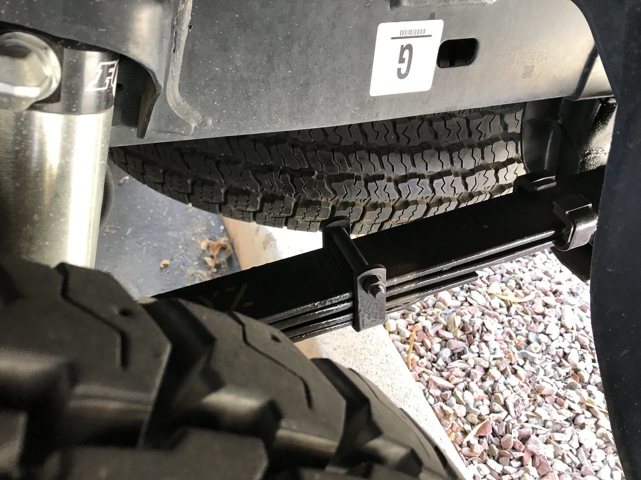

  20. Jun 27, 2017 at 12:29 PM
    #20
    chucklefunkk
    Jan 1, 2017
    #206229
    462
    So. AZ
    2016 TRD OR
    Here's a photo of mine with the stock spring clip removed.
