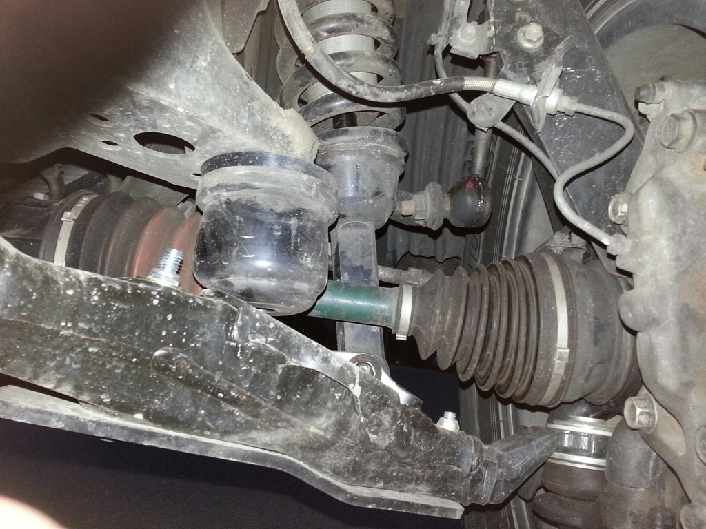

    Here's mine at almost full stuff. I have aftermarket arms so i have an extra metal spacer under mine which already have that 3/8 spacer on them. With the weight of the truck behind it these will compress more than this, like down to an inch or less...

    Trimming is just something I was questioning...I love mine too.
    :eek:
    I'm sure mine looked like that when I ripped my flare off last year. It appears I'm running a larger tire though (295/70r17), so I added the bump spacers to try and not do that again. I really don't want to cut the whole fender and flare until I jump up to 35's...some day :rolleyes:.
