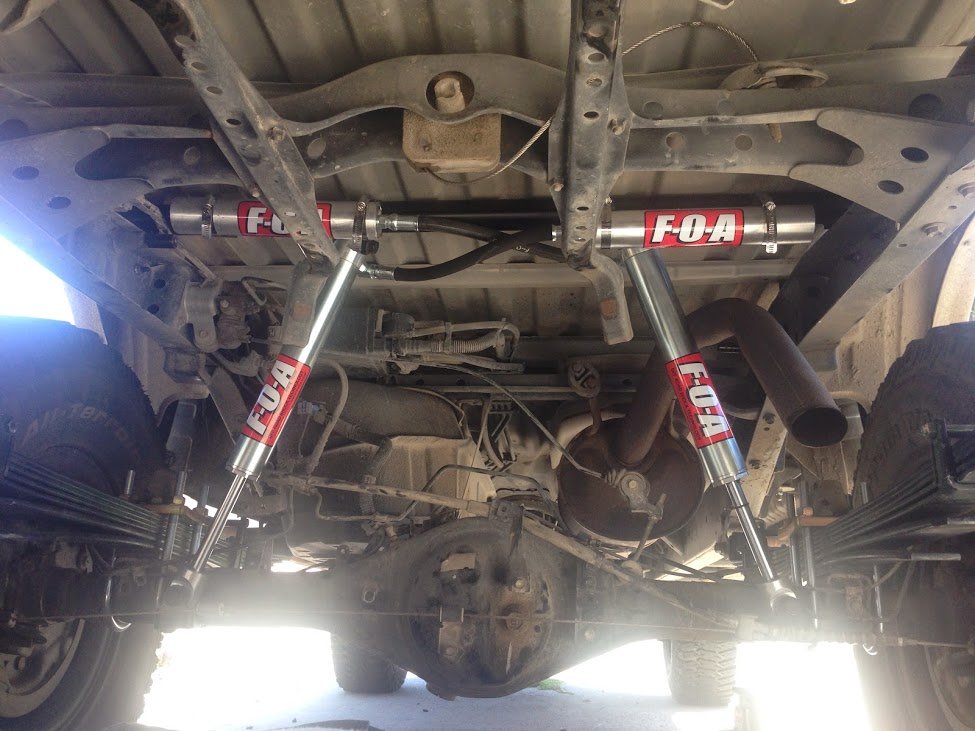

    so i was looking at these. have heard great things [​IMG]
    and these, more high tech, but might be worth it. [​IMG]

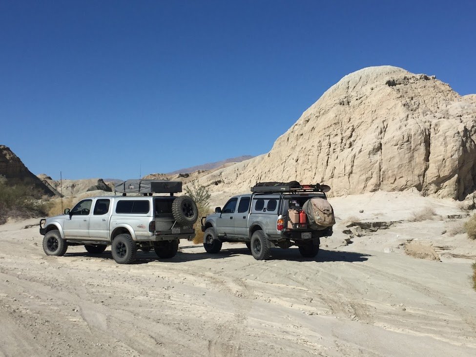

    pic of the overly heavy truck (on left)
    hTxHdYJ0kXWjQXp0bXLGxY-iJ7taX4_9MRBVOFqS_ca5aa4bb1c333b8fee4bd56b6f3db6ff954a8b6a.jpg
    and in this pic you can see how much up travel i have.
    h7LX54xQUqUVxW-svzJ7DxuP0GLkNldFVxTA2gB-_2a9b0068f78689566191f58089973eafbbdb5bd7.jpg
    patbegley likes this.

    Ok, OP, I see your issue already. You didnt cut down your U bolts with the Flip Kit and are using the stock bumps. The bunps stick up past the U bolts just barely, so you are using your ubolts as bumps lol. Cut those U bokts down and get Superbumps to start

    sorry i should have mentioned that, was a pic when i did the ubolt fip but before i cut them down :D have made that mistake on an older toyota and ended up pushing all 4 ubolts in an outward pattern lol, made it very fun to cut off.
