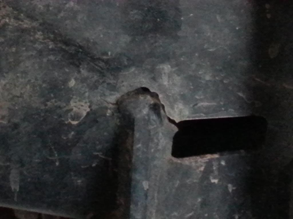

    It just snapped while being on a dirt road?

    Nah i planted that tire in a rut comin out of a nice lil drift, the tire caught the main birm and tried to climb it left as the truck was going straight and boom, snap, lca fail, sad stefen :(

    Fuck man. If i would have had my backup set of LCA's here in Phoenix i would have driven up there ASAP to get your rig up and running.

    no worries man, Josh (xSectionxEightx) hooked it up! jake and I already grabbed the arms, just gunna head out in the morning to begin surgery

    Cut the tab off, fix the crack, then get some adjustable clevis' so they mount up higher above the crack. That spot has so much tension it will probably re-crack if you just weld it
