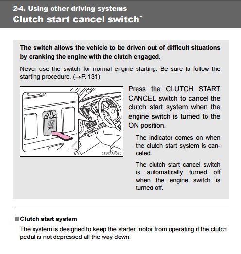

    The clutch cancel is only to start the truck. That's it.

    I'm 99% sure I read in the manual the clutch cancel is for off roading, like mentioned above.

  16. Sep 8, 2016 at 5:26 PM

  17. Sep 8, 2016 at 5:29 PM

    Whaaaat! I'm getting my manual now. I don't remember that. :annoyed::eek:

    Haha! Yeah, I read my whole manual when I bought the truck. I just downloaded an electronic version to double check myself.

    I would use it sparingly but when you start getting tippy, let it stall.

    You learn something new everyday. :thumbsup: I'll try that on my next trip.
