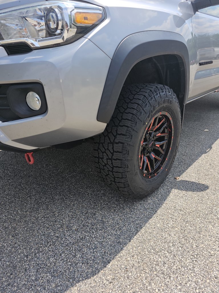

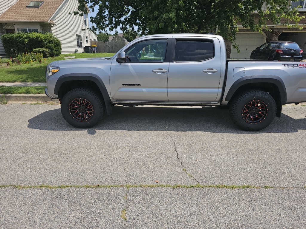

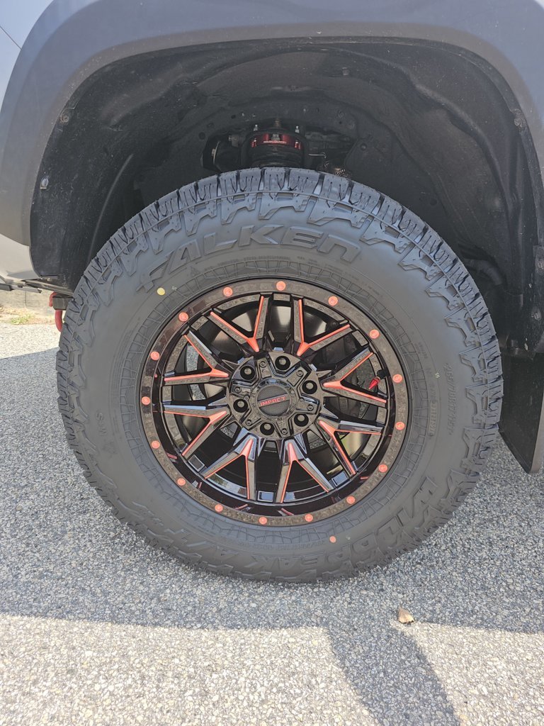

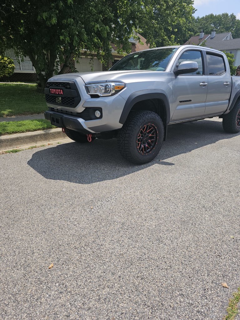

    I have 265/70R17. 17x9 wheel. 0 offset. No trimming. No rubbing. 2in level kit. Love the look of it.
    I used 1010tires a lot going over the difference in wheel clearance.
