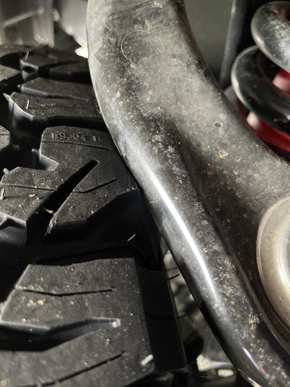

    A little flexed.

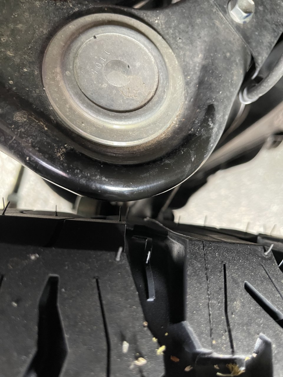

    OEM lift 2” front 1.5” rear, Black TRD Pro Grill,275/70 R17 KO2 Tires, Backflip Bak 4x Tonneau Cover, Mountain Hitch Tailgate Insert, Tint, 17" FN f(x) wheels.
    Rubbing on the upper control arm. Turning completely to the right.

    71tattooguy
    71tattooguy Well-Known Member
    Dec 19, 2018
    #276275
    5,880
    Dino
    Petaluma , Ca (707)
    2019 DCLB TRD OFF- ROAD
    Kings 2.5” front and rears from Accutune / ICON RXT LEAF PACK black badges doors and tailgate / method 315 / 255/85/16 Yokohama G003 / magnaflow exhaust , axle dump / meso int delete kit / meso led map lights / dome lights / wheelers front super bumps / accutune Flip kit with spacer and new bumps / Cali raised fog light pods / Cali raised ditch lights / RCI FULL SKIDS / SLIDERS / RCI rear bumper / rigid backup lights / tuned on 4.88’s
    Spidertrax or bora wheels spacers will fix your issue

    getlostMT
    getlostMT Member
    May 7, 2021
    #365030
    11
    2021 TRD OR
    TRD Lift Kit, 2019 TRD PRO Wheels, TRD PRO Skid, Toyo Open County RT 285/75r16, Diff Breather Mod
    It is really the combination of a few choices, to get 285/75r16 to fit. I would not say that all it takes to add 285/75; is some minor plastic trimming & different wheel. Each wheel offset & tire type/brand is different. In my case the selection of this exact set-up helped me achieve no issues under full lock and flex: 2019 TRD PRO wheels (Offset +13), 285/75r16 Toyo Open Country RT. Between my wheel/tires choice & some of the clearance mods I made, I would recommend this to anyone and feel confident I was not leading them astray.

    Ydog32
    Ydog32 [OP] Well-Known Member
    Mar 8, 2021
    #358660
    59
    Wyatt
    2021 MGM DCLB TRD Sport 4x4
    I know what you mean, I was just being overly simply in my response. It takes a combination of elements to get a 285/75 on a 3rd gen Tacoma. I’ll save your post for the future though. Really didn’t want to get spacers or new rims… such is life!

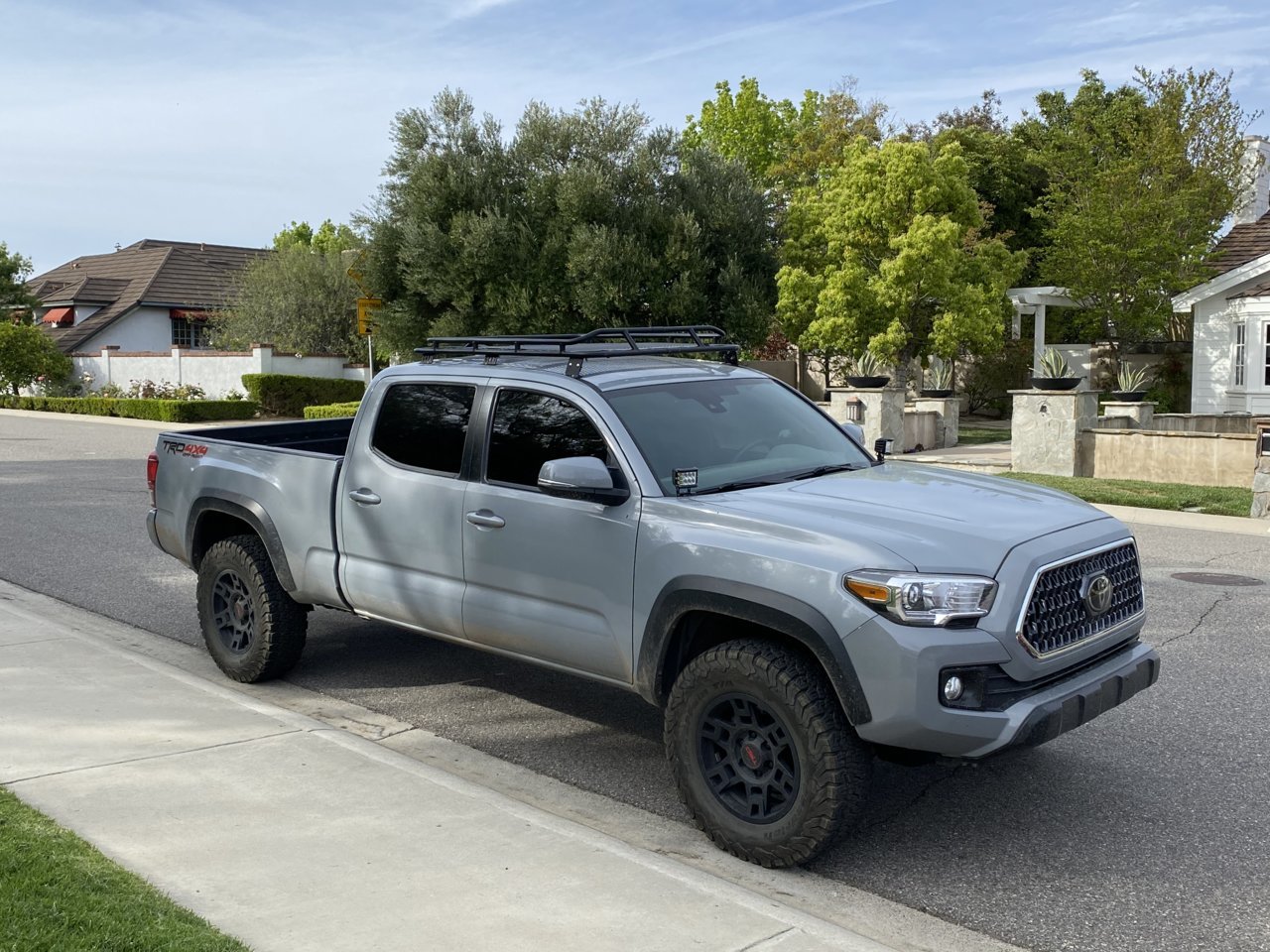

    Paulndot Well-Known Member
    Apr 22, 2020
    #325488
    493
    2020 TRD Off Road
    I went with General Grabber A/T-X's in 275/70/17 on the TRD Pro Wheels (4Runner). No rubbing at full lock or at articulation. A bit quieter than I remember the BFG's being.

    Paulndot
    Apr 22, 2020
    #325488
    493
    2020 TRD Off Road
    THANKS! I read that a few folks had rubbing issues running the 275's on the stock 16" rim, but I think it was more of on offset problem. The 17" TRD pro rim is pushed out a bit from stock (almost an inch) so there's more clearance at the UCA and the fender lining (at full lock). These are 17X7 though - at 8.5" wide, that's 3/4" on either side of the rim (depending on offset of course)...tricky.
