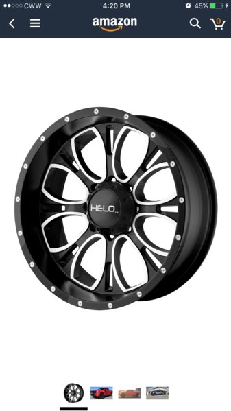

    I have a 2001 Tacoma and currently running 265/75/16 tires with a 7" wide wheel. I just purchased 16*8 Helo wheels and have 1/4 spacers already. After I get them mounted will the tire stick out from the fender more or will it even move at all? Anything helps! Thanks!

    what's the backspace and offset on the Helo's? that will determine how far they stick out

    The offset is 0mm and the backspacing is 4.5'', frizzman,
