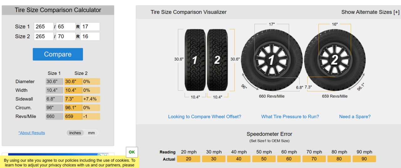

    1. Comparing sizes above, any of the two tires bigger than the other? Diameter wise?

    Google "tire size calculator" to answer your first question.

    1. They’re the same, just on different rim sizes.

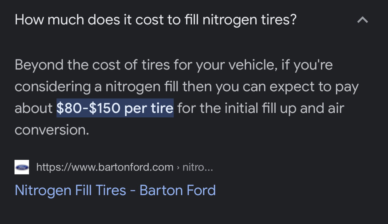

    What’s up with the Nitrogen? Dealer did that to mine acting like it was all special and that.

    Nitrogen is less susceptible to pressure changes in relation to temperature. So when the seasons change and say the temp drops for winter, you are less likely to have low tire pressure because of it. Same for the hot months and high pressure (also less pressure increase due to just driving on the tires because tires heat up while driving)

    Not sure how true but google says:
