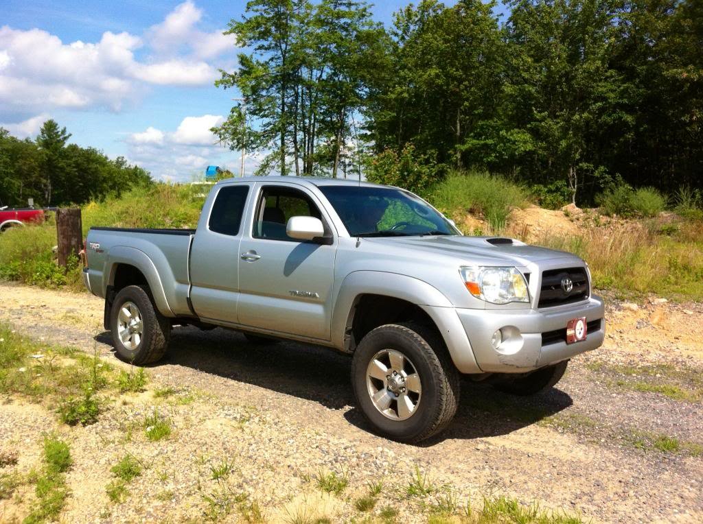

    Hello all, I just bought a 2007 Tacoma TRD Sport with a 3" lift. While i'm not completley new to trucks, I am having a hard time finding the information i'm looking for. The truck i bought needs new tires and the wheels look pretty crappy up close, so I think i'm going to go with new wheels and tires for it. I'm having a hard time deciding on what sizes to go with.
    As far as tires, I am probably going to to with Cooper Discoverer AT3's, but unsure of what size to get. Through some research, I saw that people seem to go with either 265's, 275's or 285's. I do not want to do any trimming and defintley dont want any rubbing, so i think i'll go with the 275's.
    For wheels, I was thinking of going with 17x8, or 16x8 but i dont know what backspacing, offset, etc. to get. I saw people going with 4.5" backspacing, which i believe is slightly less that the stock wheels, i'm not sure though.
    I am just looking for a nice aggressive look, without the tires extending too far past the fenders (illegal in PA), and without them rubbing anything. Any info anyone can give would be appreciated. thanks...

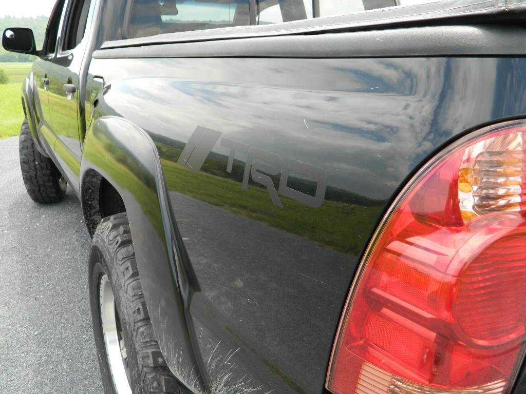

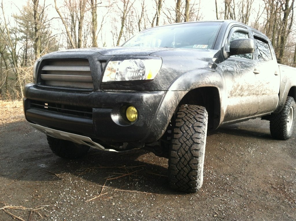

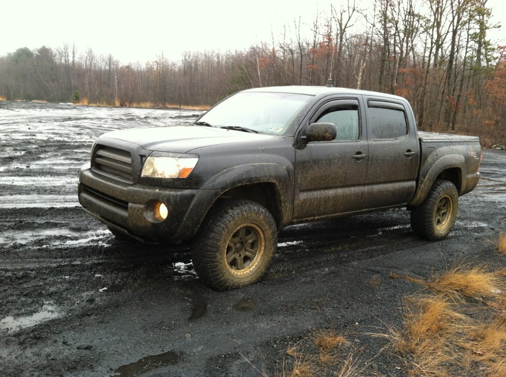

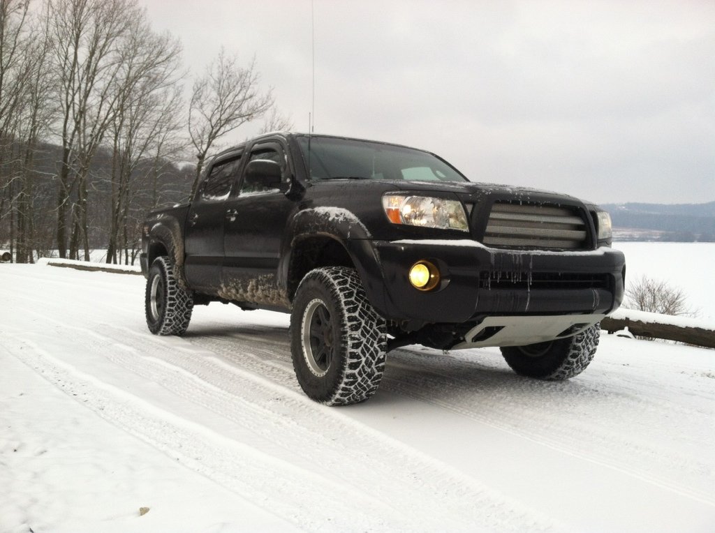

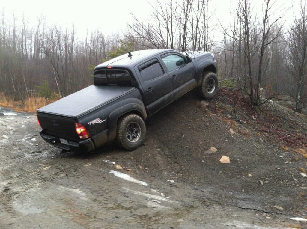

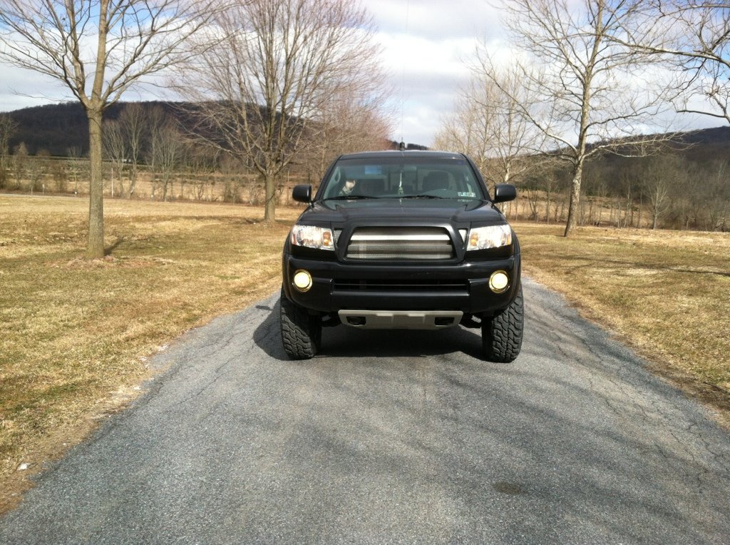

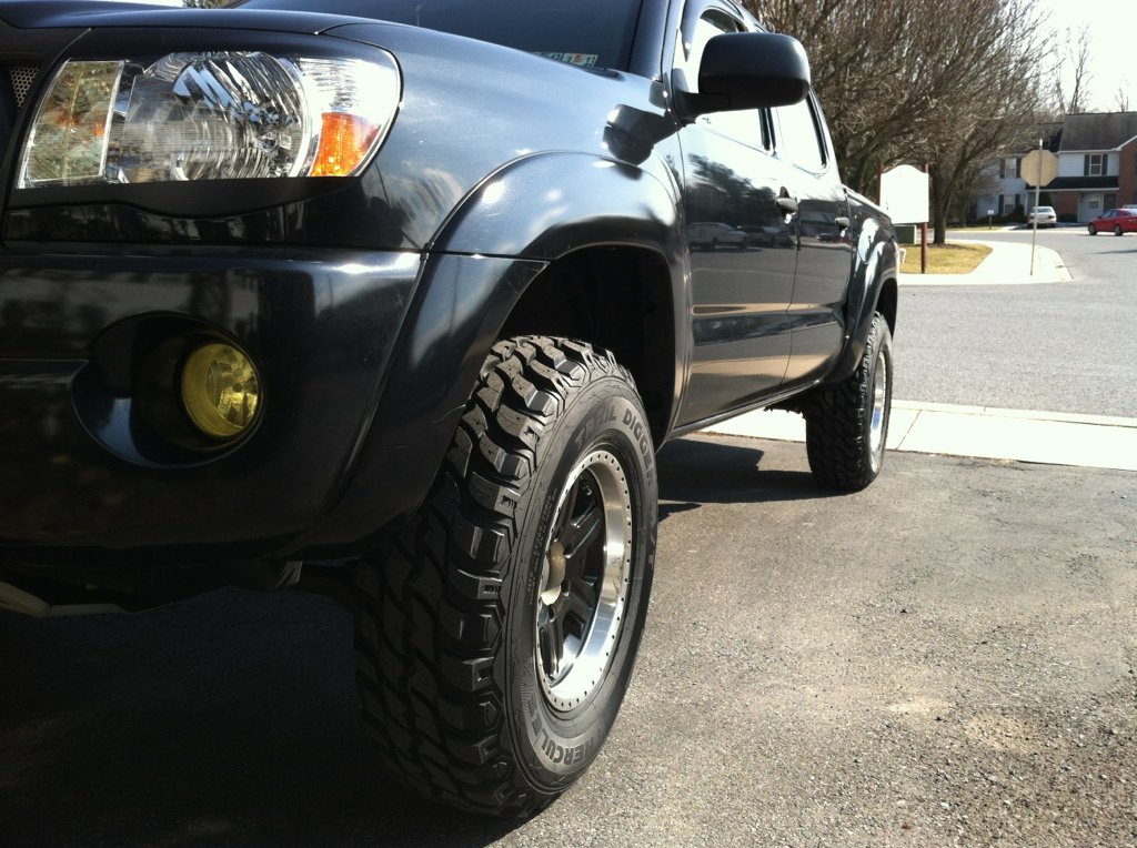

    With Duratracs....
    6FC61953-F21B-452D-8D4B-DE2612A97293-524_22a070f05ea663ad32c577868840b1743ee7f4b6.jpg
    8D0691C6-C42C-445D-9E4F-B9C455B806F9-524_1beb2801be12688217746c4eecca541259e7b4f1.jpg
    2035F8EE-D687-4652-9C29-E0096FFB4A3B-518_1b5082c577be7d2b1f7577ba5af0ddd9073154b1.jpg
    2D10774D-3645-4D9B-B2F6-1A2974191B03-422_98f7070e7b1d6ff804e3e9e91384122bcae8e262.jpg

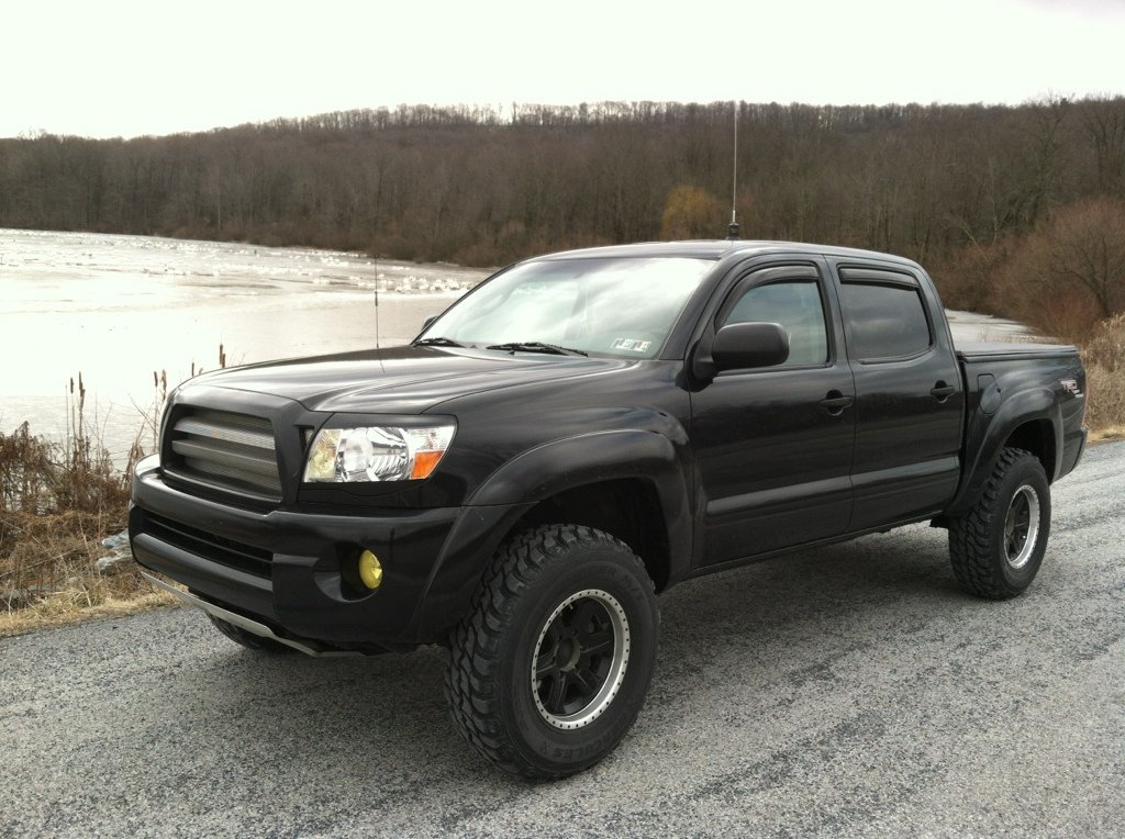

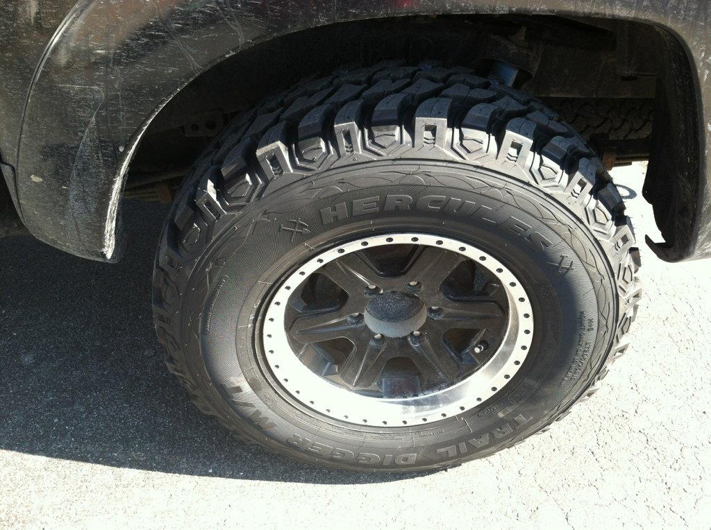

    With Hercules Trail Diggers (slightly taller and narrower than the Duratracs)...
    9FDEB691-6EBC-4FD7-BFB5-1A5B098F32EB-581_f3c42a3aefdd65b89bc908589083f3a11f491af2.jpg
    49607588-3C1D-49D4-8851-58E04DED063B-199_654258f2f689a70c0f7aae4257f6e30b43cb5d94.jpg
    47D3475E-9A6B-4BC9-9580-7A29707782BF-538_3b154be95532292fdbcb17f8bdef584d8b714da2.jpg
    1405E7EE-B8B9-4F89-9EFD-BA5A7114E15F-538_2f27a8b4c1b8ab61484b8d8eb243061f74e7b075.jpg

    that looks great man the exact look I want! where about in PA are you from? looks like you're in some coal dirt in the one picture!

    Yep, a few of those are from a wheeling trip in Shamokin. I'm from Lancaster county.

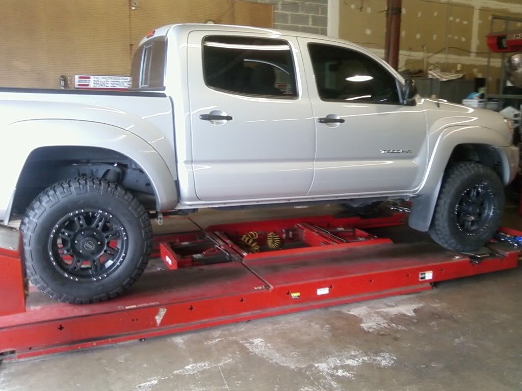

    I realy like this wheel/ tire combo on this toyota, can anyone guess or tell what sizes these would be? lol..

    Agreed. Perfect stance, lift height and wheels.
