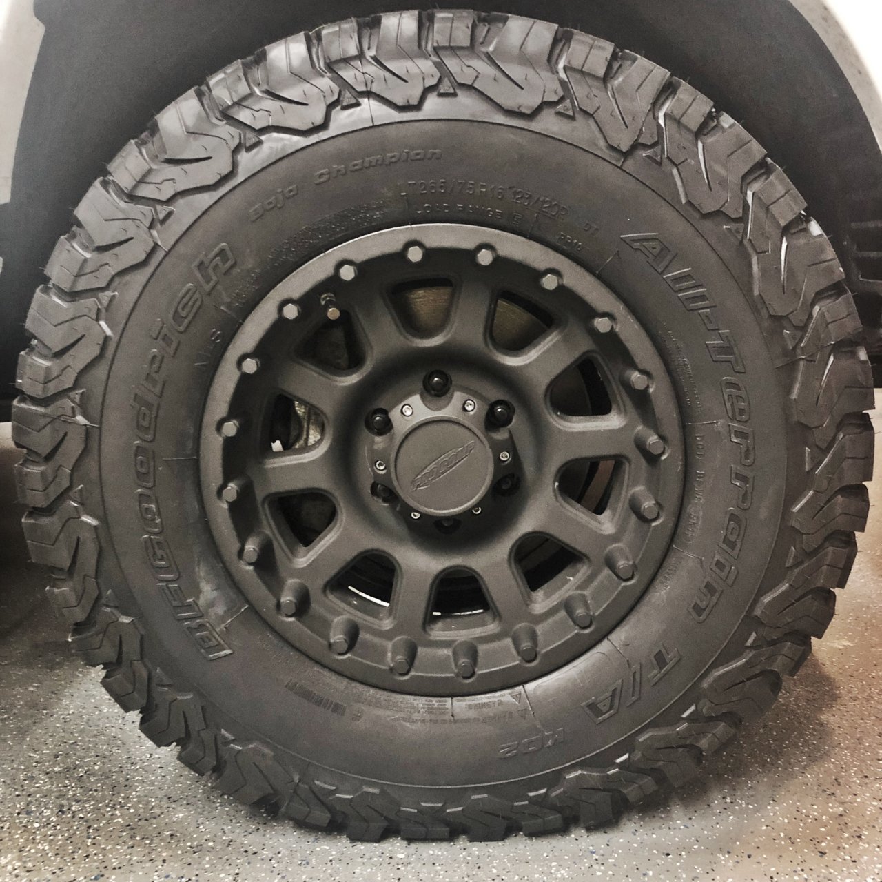

    Guess I could have given you more info too...
    My current set-up is Pro-Comp 32 Series wheels (16x8, 6-139.70 BKMTXX, 4.5 backspace, 0 offset) with BFGoodrich T/A KO2 LT265/75/R16’s. I had 265 Wildpeak AT3W’s, but they shook the hell out of my truck even after 4 balances and an alignment. No vibration with the KO2’s.
    Had slight rubbing at full turn on the plastic in front wheel well, so I cut a little out of the inside.
