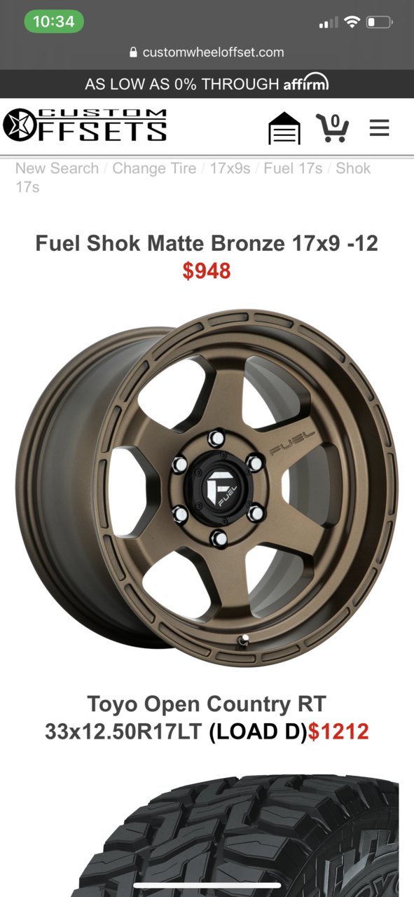

    hey I was wondering if some one can help me and let me know what kind of clearance issues I can have with this set up I’m sure Ill rub on the cab mount but i don’t know if I’ll run in to more problems other then slight trimming. Also on an OME 3” lift

    Any lift? 12.5s are pretty wide

    With that wide of tires and -12 offset I would think you'll definitely rub on the cab mountand possibly the pinch weld and rear wheel liner plastic in the front wheel well.

    The wheel spec is fairly aggressive with it being 9” wide with an offset of -12, not to mention the 12.5” tire.
    Cab mount chop is definitely a foot in the right direction. You may need to trim plastic the fender liner and remove the mud guard if you have it. If you plan to compress the suspension, I would hammer the pinch weld back as well.
