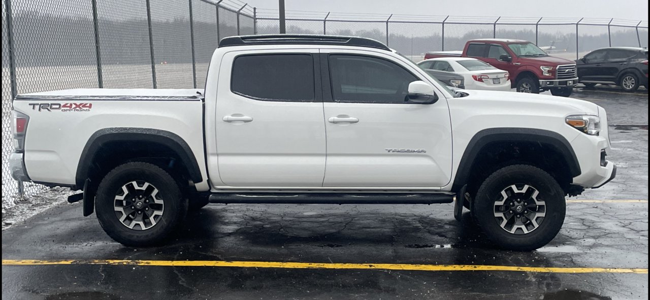

    Hey group! 2021 off-road, 2” aFe leveling kit. Can I run 275/70R17 tires with a neg 13 offset. I’m looking for about 1.5” outside the fender well. Any help is appreciated0B7C217C-D20C-4832-8589-011F9572983C.jpg

    Can you? Sure.
    Will it rub? Almost certainly.
    Stick to close to 0 offset if you want to avoid major cutting and trimming.
    Or go for it and trim if needed (what i would do).
    Good luck!
