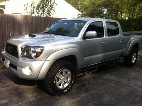

  15. Oct 21, 2012 at 5:31 PM
    RI Tacoma
    RI Tacoma Well-Known Member
    Feb 24, 2011
    #51797
    1,487
    Tim
    Phx sometime soon
    2011 Sport DCLB
    OME 885's, Derped FJ TRD Wheels, Hankook Dynapro's ATM 265/75/16's, Retro's, WeatherTech Liners, Fog Light Mod, Bak Flip F-1, N-Fab Steps, 20% Tint, complete stereo, heated mirrors, Katzkin seats!!
    Silver tacoma with the silver FJ's look pretty good. Picked mine up a while ago and I couldnt be happier.
    Its a shitty iphone pick and I have a yard of mulch in the back, so its dragging a little.
