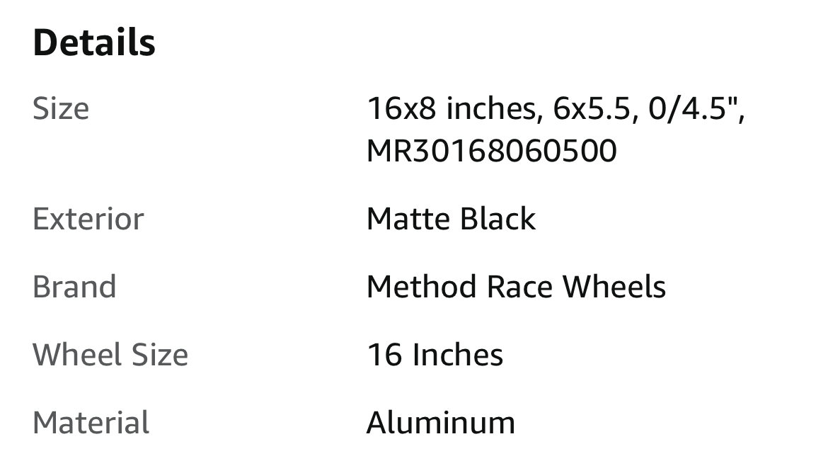

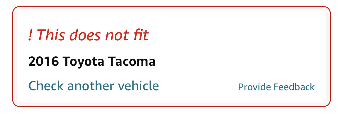

    Can somebody explain this to me?84C220B2-2CEA-4327-8373-8EBB19E22BE0.jpg 3A30A558-57DA-4779-8608-35514E0D5935.jpg

    Amazons fit guide is imperfect. Unless the seller writes out every single make/model in every year, it's an incomplete list.
    If the wheels fit a 6x 5.5 bolt pattern, then they'll bolt onto the Tacoma. Even with a 0 offset. :cookiemonster:

    Looks like it has a 108mm bore; Tacoma is 106.1mm. You could get hubcentric spacers, but I'm thinking the center cap won't fit. You could go without the spacers, but you'll need a lug centric balance. If you get the spacers and a hubcentric balance, you are relying on the spacers keeping the same center of hub bore and that they machined the centers of the bolt circle and hub bore to coincide to a tolerance that won't cause balancing problems.

    Thank you guys. Saved me some time and headaches.
    I ended up getting the Fuel Revolvers instead.
