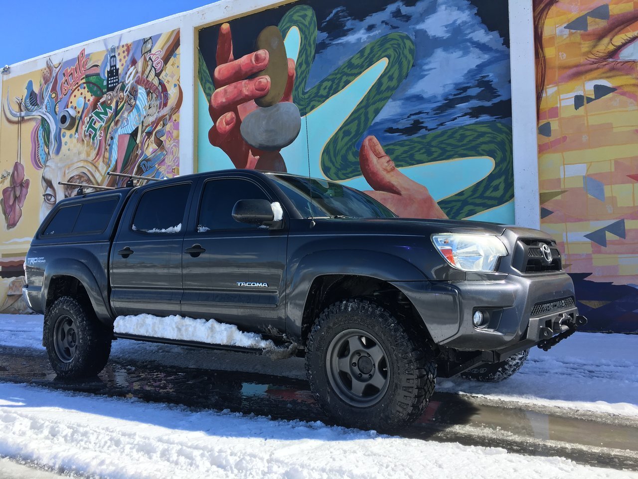

    Just put some 16x8 SCS F5 on my truck. 4.5" back space and 265/75/16 Duratrac in a C load range.
    How aggressive does she want to get?

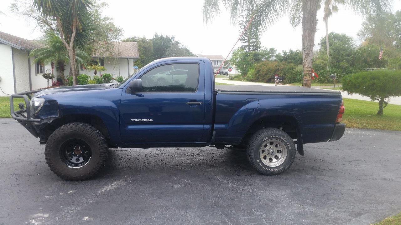

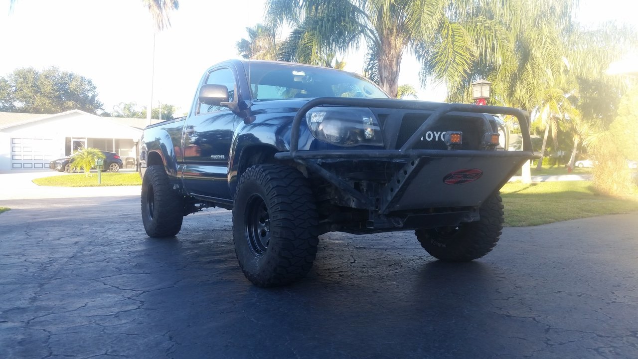

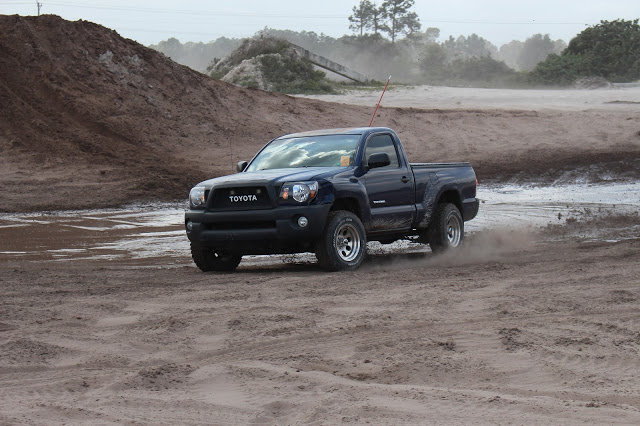

    The fender flares for a 5 lug are the same for a 6 lug. Bushwhackers are typically the way people go. As for rims Ive had 2 sets now
    Our magic numbers are
    5 x 4.5 lug pattern
    4 in BS
    0 to -13 ish offset (positive no good)
    The first was Mickey Thompson Classic 3s in Silver I did need a 1/4" spacer and extended lug nuts. Now they were -44 offset and didn't really stick out with 235s but with 33s it was too much.
    The second set Im running now is Cragar soft 8s with the 1/4" spacer again. These are -13 offset but because the tires are 12.5 in wide they stick out slightly more.
    Lol and here is them side by side also showing the difference between 33s and 235s
    If you want i got plenty of more pictures lol
