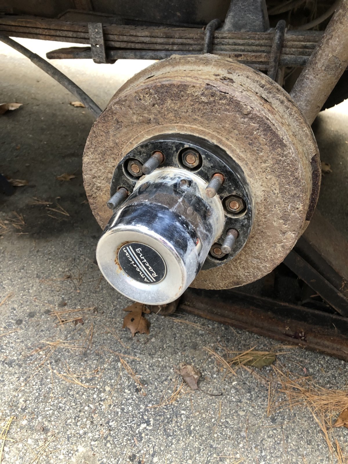

    It was the center bore, and unfortunately it was off by what seemed like less than 1/16 of an inch! So frustrating. Here's a pic of the hub and spacer with the wheel removed. The tires are beefy, so spacer for neg offset is definitely needed to prevent rubbing.

    Just find a spare that someone is selling for $20 or free from their brand new 3rd gen. Facebook, craigslist are good places.
    The stock steel should fit and if not, it's so cheap that you can just take some sandpaper to it to make it fit over your current setup. It wouldn't be much less safe than those spacers and thin extruded center cap anyway.

    Ah, I bet the wheel you got will fit if you remove that center cap. Maybe grind outa bit the center hole of the wheel you got?
