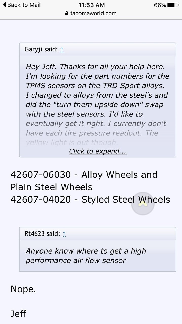

    Any wheels will work but you will definitely need new TPMS sensors to do it right.
    Although, if you have the base steel wheels instead of the "Styled Steel Wheels" the Part number for the TPMS is the same as the alloys.
