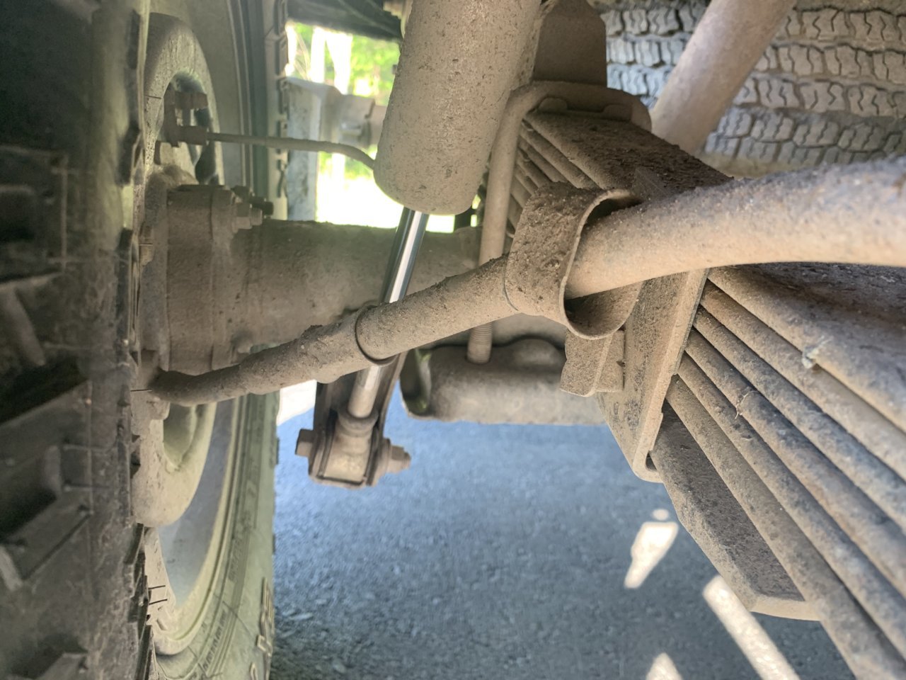

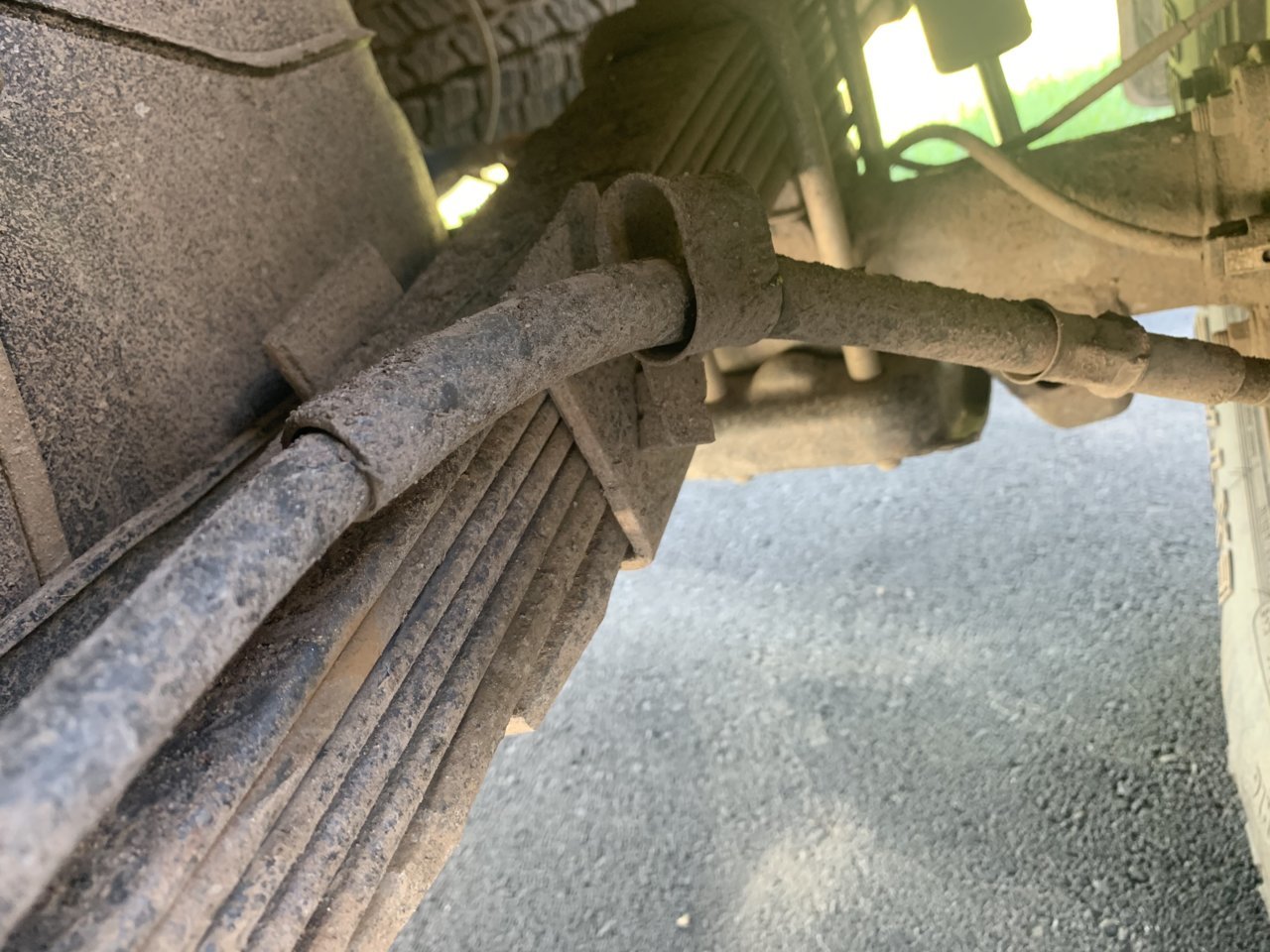

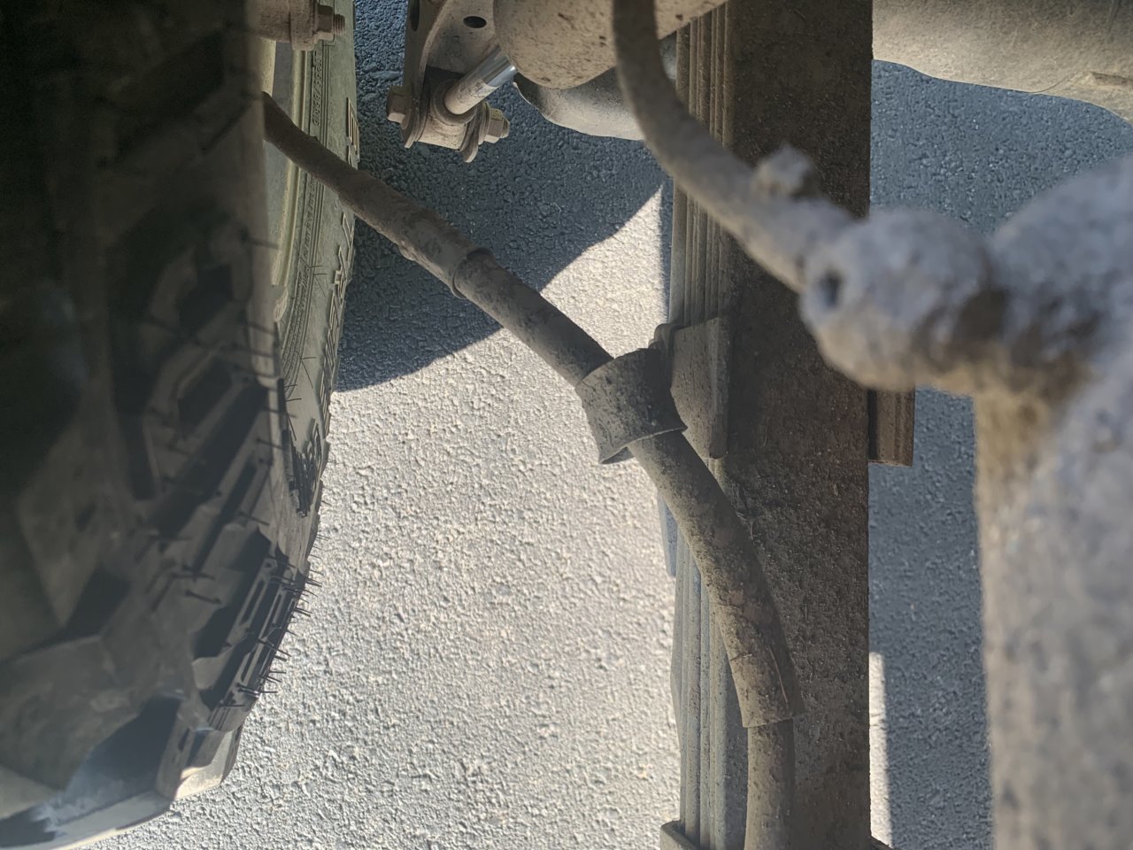

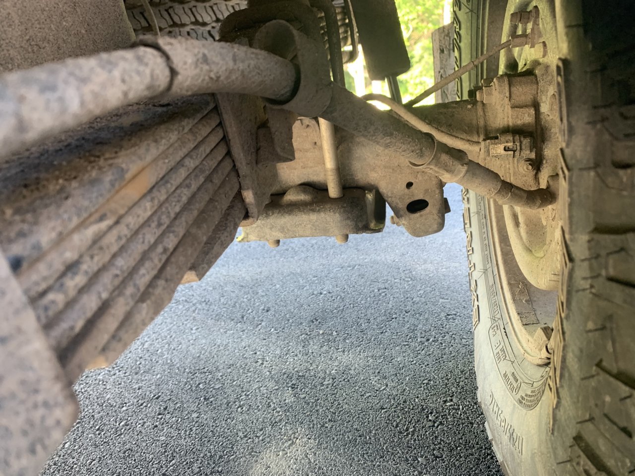

    I'm thinking I'm going to start with that. I'll take a picture when I go out there tomorrow but I know there is some strain on the ebrake cable from the lift that I always said I'd get around to and never did yet. I just wonder why now after a year of having the lift on is it creating an issue.

    Parking brake cable strain. I am going to start with this and see if that does it. Only wish I had a better way to duplicate the problem.

    Yeah bend that metal tab out.
