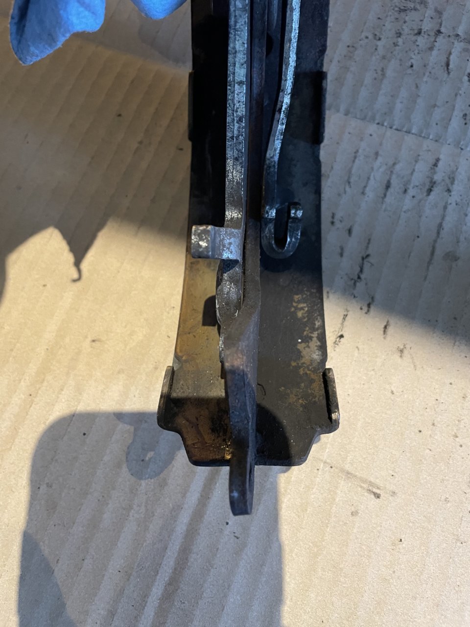

    2017 Tacoma TRD
    OME BP51
    Both shoes at the lower end were bent.
    I did call Toyota with not resolution; they were the last to service my brakes. I also noticed that my rear leafs are now slightly racked. This was most likely due to my wheel locking at 30kms/hr.
