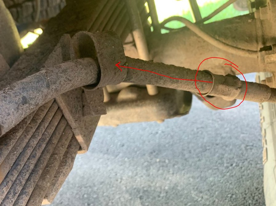

    another cause with people asking about e-brakes...shouldn't this bracket be protecting the line from rubbing the retaining slot?
    Did it slide out of place?
