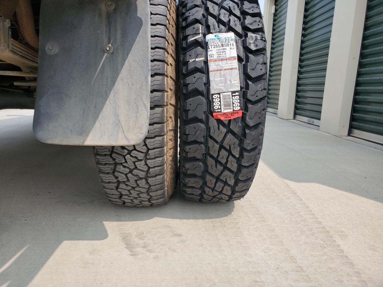

    My Tacoma had C load BF Goodrich when I got it.
    I forget the tire pressure on that, and well that Tacoma sold months ago by accident.
    The 4Runner's tires are at 32psi atm.
    The Falken's next to the Cooper's as I didn't know what tire to run on what vehicle
