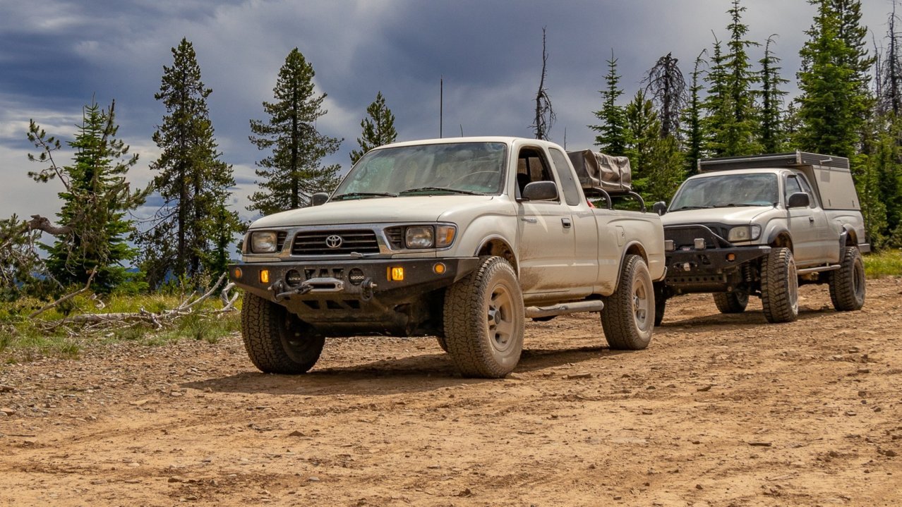

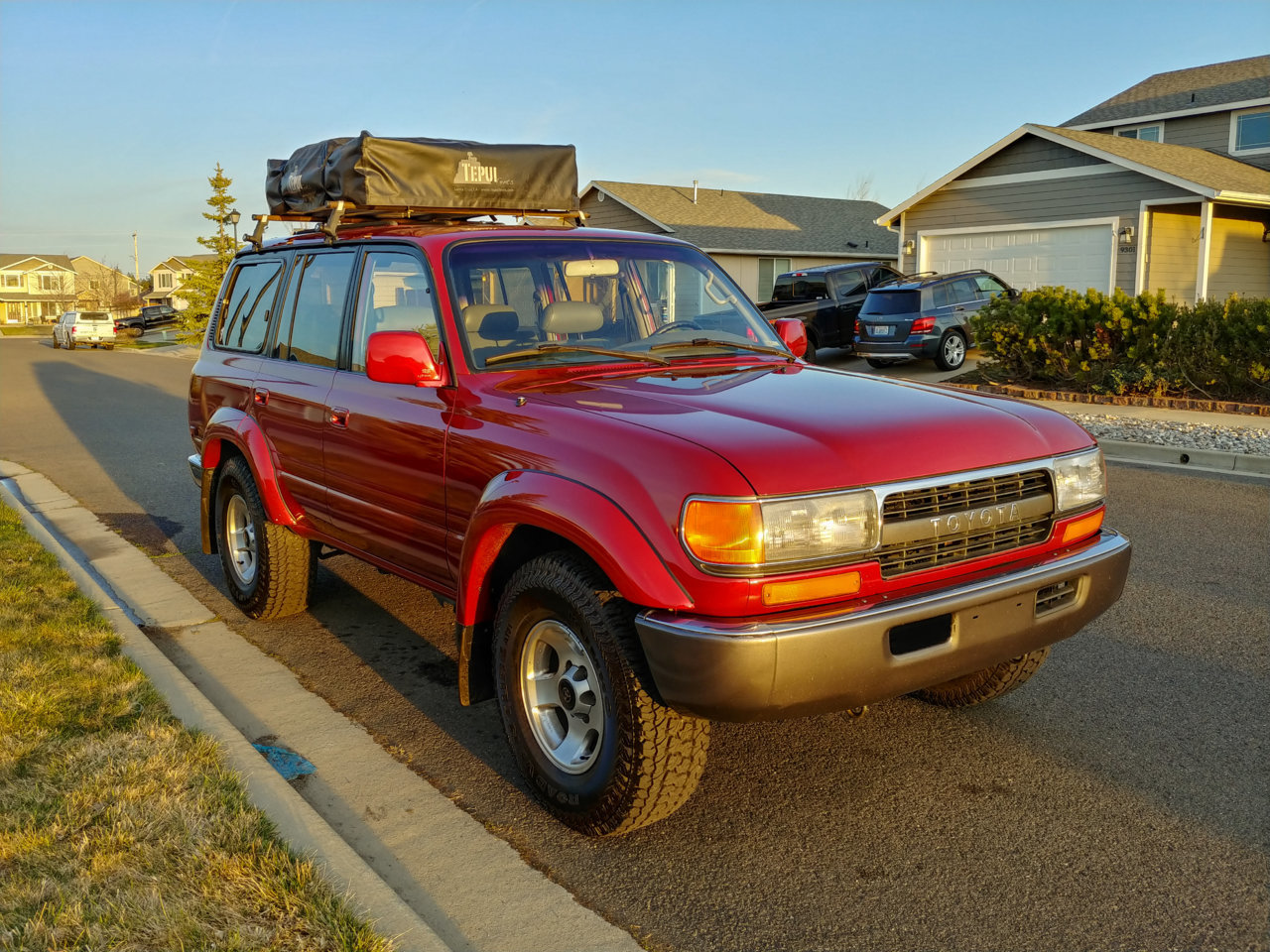

    I run Kumho AT51s on my Land Cruiser and love them, affordable and they grip great.
    Put em on the Taco before too, been on many trips off-road and have held up tons better than my KO2 ever did.

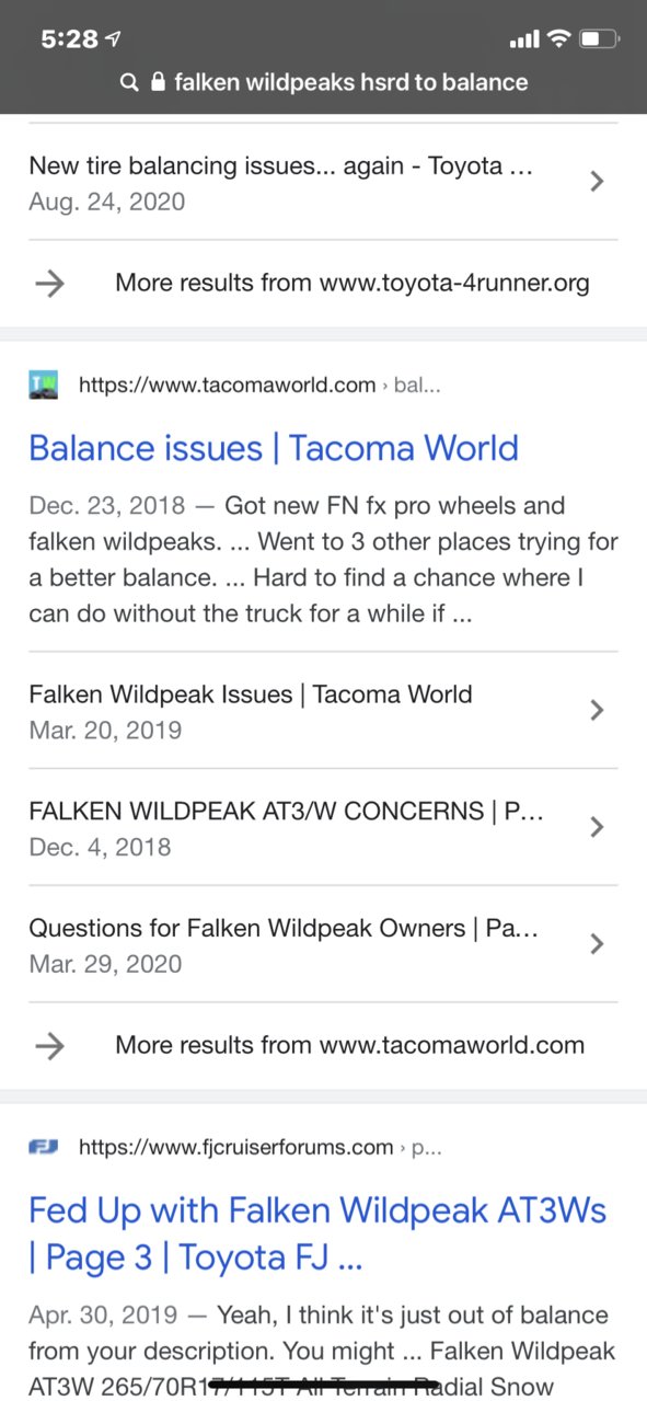

    The thread pattern looks superior to KO2s, nice.
    One of the reasons I really like KO2s is the beefy sidewall they offer, also they’ve been great off-road.
    None other AT/RT tire has that much meat on the sides.

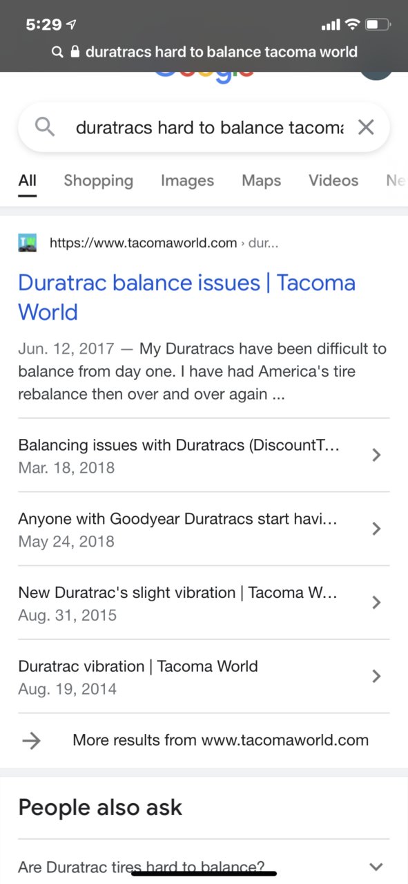

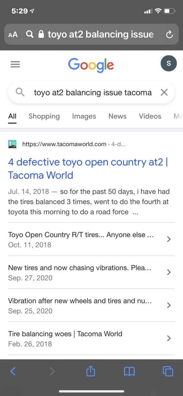

    K02s are the problem.Lots of threads about it.

    Haha yeah. Maybe I just paid more attention to the KO2’s cause I run them.

    I had a set of Toyo AT2's that never were right! I always had a little vibration at 60-70. I put them in and it helped most of the time. I dont know why but only sometimes I would get a vibration still? I just put on a set of Goodyear Ultraterrain AT's and it hasn't driven this smooth since it was new. Can you take them back to the Jeep dealer?

    Serge, you liar lol.
    Mrbfgko2man88 should be your new tag haha.
    It's ok though because you're right. I loved my Wildpeaks, never had any issue in 50K miles. Other people here think they are the crappiest tire alive. It's a lot of money to spend on a crapshoot, but that's the world we live in nowadays.
