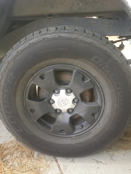

    I have second gen wheels on mine. 20160104_133739.jpgThese are the 6 lug offroad wheel.

    So any 2nd gen 6 lug wheels will work? I like the looks of those , will keep my eye out for some, Thanks.

    As far as i know yes. The backspacing is different though on these. I had to buy spacers when I went up in tire size (33") to clear the uca's. Here is a link to different toyota wheels and specs... https://www.tacomaworld.com/threads/wheel-specs.30754/

    if you keep stock tire size any 1st/2nd/3rd Gen Tacoma wheel with a 6-bolt pattern will fit. 4runner and 1st Gen Tundra/Sequoia as well
