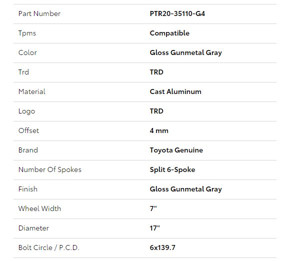

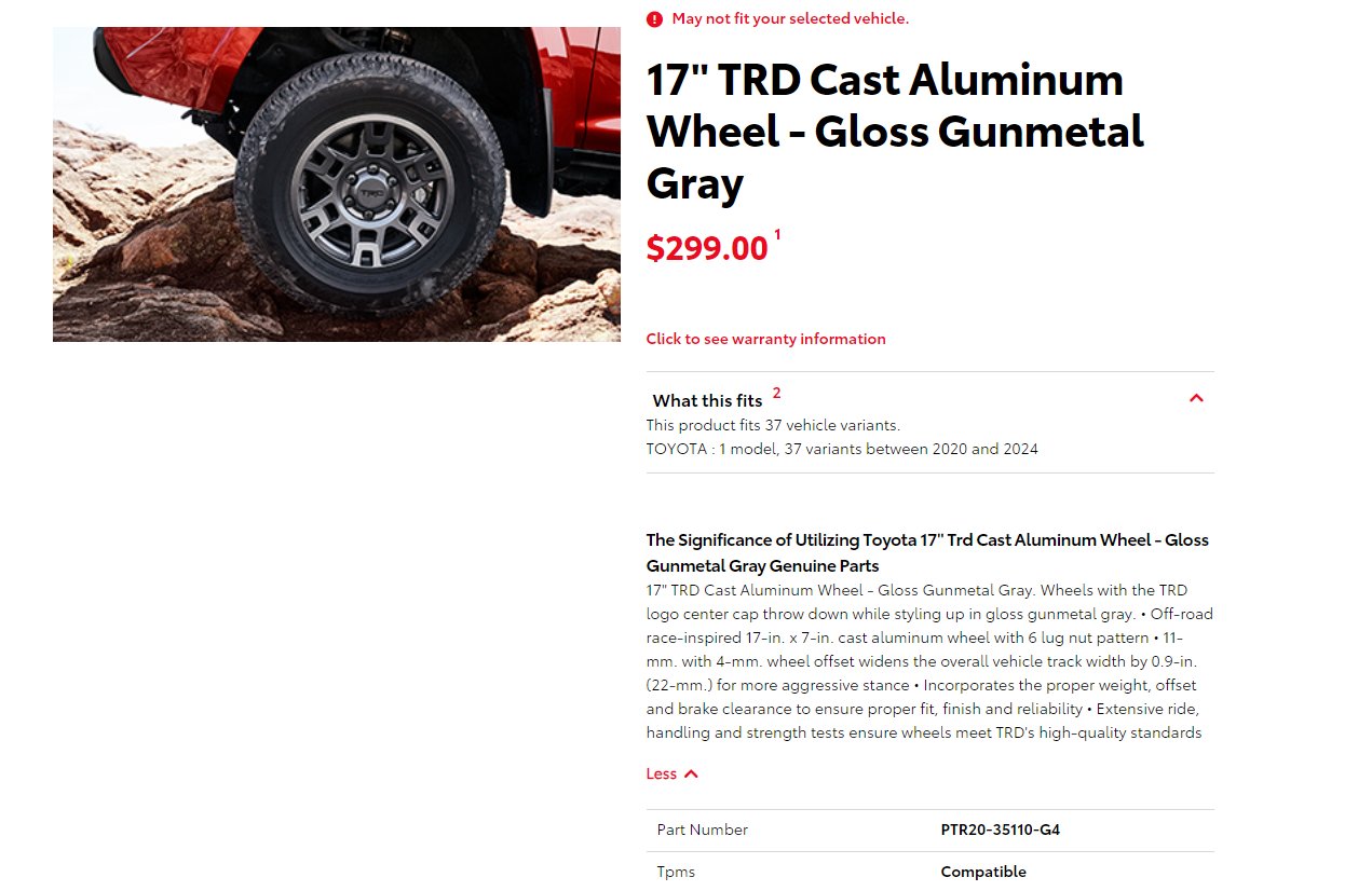

    I'm wanting to finally get some new wheels / tires for my 2nd gen sport. Looking at getting 265/70R17/C BFGoodrich - All-Terrain T/A K02's along with gray TRD wheels. Still new to all this, is there something I'm missing with fitment? This is just off Toyota Website. Shows only compatible with 2020-2024? Just wanting to know if this would work, or if anyone has advice on better place to look. Still stock suspension but will probably do a few in lift in the future. Thanks in advance!

    They’ll fit. If you currently have factory aluminum wheels you can reuse the lugs. If you have steel wheels you’ll need new magseat lugs.
