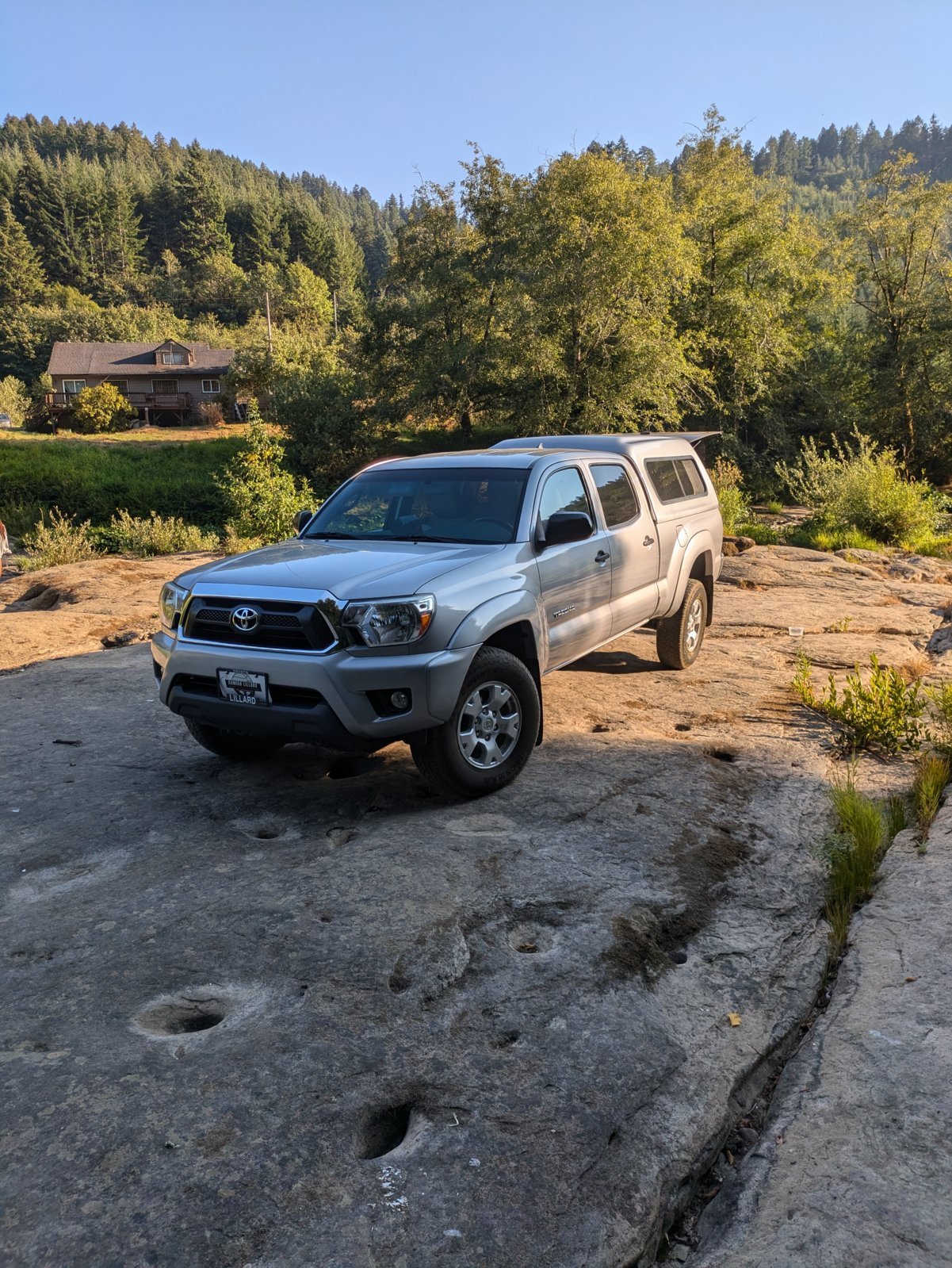

    This is how she sits currently 86k miles 4x4 with canopy

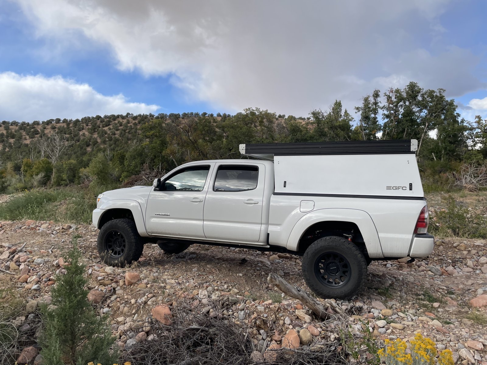

    Here’s my 2015 TRD Sport with a 2” lift and 285/70 R17 tires

    What lift are you running also do you have any rubbing with the just the 2 inch lift?

    It’s got Camburg UCAs and LCAs, Deaver Stage 2 leaf springs and Fox 2.5s all around. I took off the bump stop spacer that limited upward travel in the front. It started rubbing on the fender flares at (close to) full compression so I trimmed the fenders and installed aftermarket fender liners. No rubbing in the wheel wells with 0 offset wheels and 4.5” backspace.
