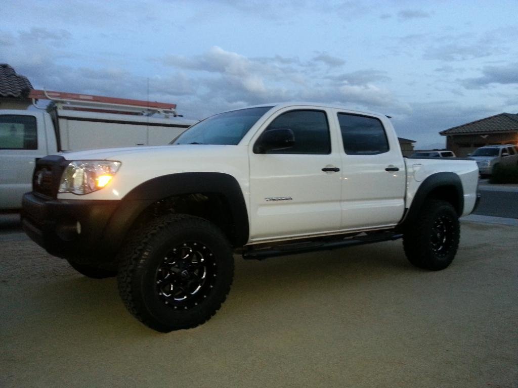

    I put a 3 inch lift on my 09 Tacoma. I live in the desert so I went with BFG All Terrain tires, 285 70 17. I had to do some fender trimming but its very easy, all you need is a box cutter. My wheels are made by Fuel, they have a cool selection of black wheels.
