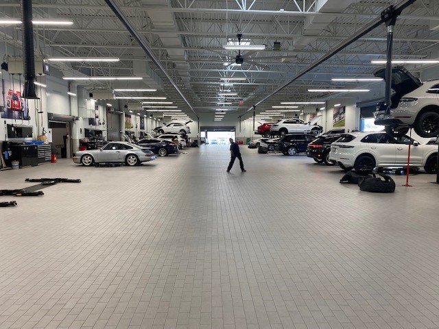

    I've seen some crazy things, but what shop were you at that has ceramic tile on their floor? It looks nice new, but I could only imagine how that grout looks after a few hundred pounds of brake dust and grime. Not to mention how chipped up the tile gets from dropping air guns and other tools.
  5. Jan 3, 2022 at 8:31 AM
    #25
    Montana_Actual
    Montana_Actual ;)
    Nov 2, 2021
    #381174
    2,124
    I'm willing to bet those are not actually ceramic tiles, lol.

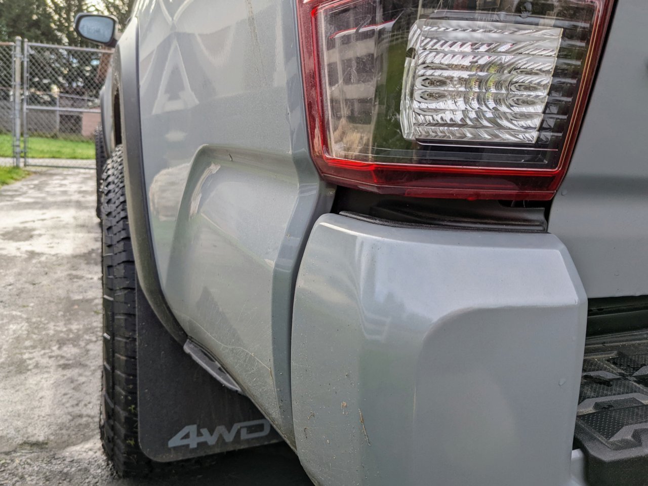

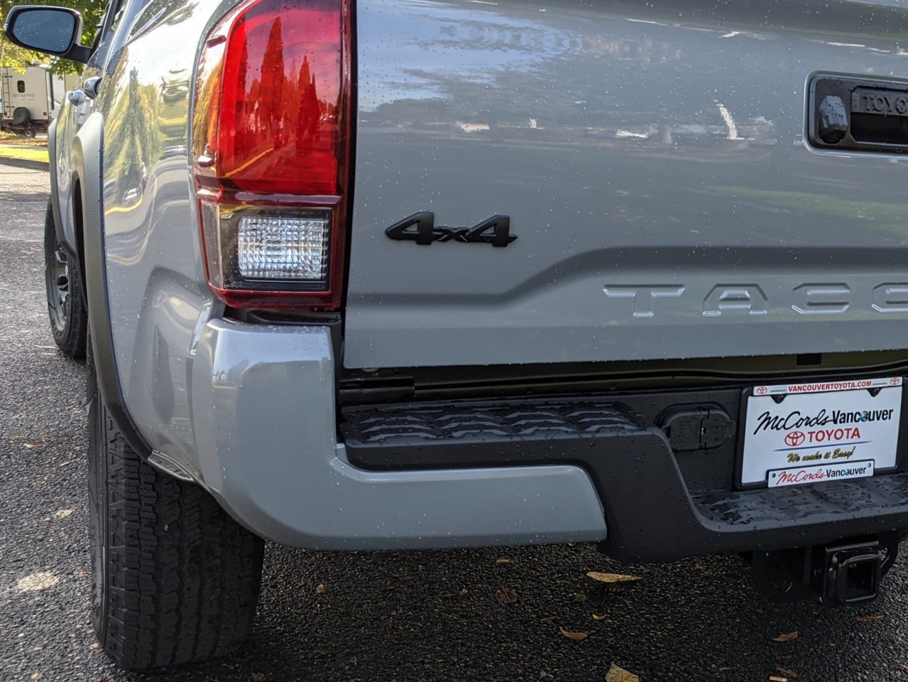

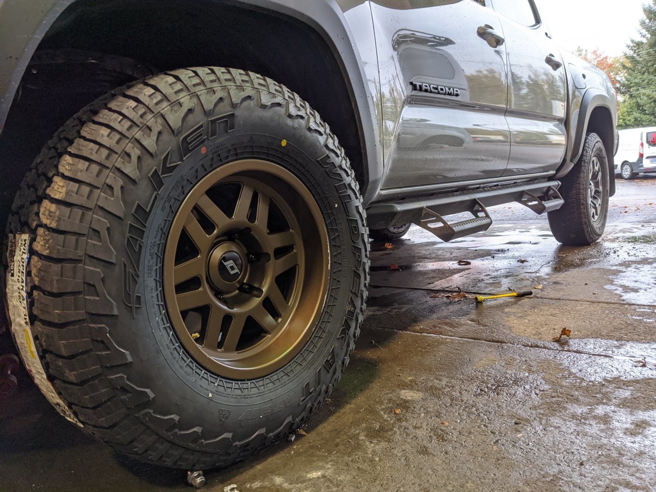

    Here's -25 offset wheels w/ 265/75 R16 vs stock wheels/tires:
    Here's how much they poke out vs stock:
    With that much offset came a lot of rubbing. Had to remove the front mudflaps, trim some pieces of the fender, and take a heat gun to push in the liner. Still occasionally rub if I hit a bump going into a sharp corner too fast.

    haha I work at a Porsche Dealership. That is about as filthy as our shop gets. We have a guy constantly cleaning our shop. Ill take some pictures for you
  9. Jan 7, 2022 at 8:16 AM
    #29
    Sungod
    Sungod Well-Known Member
    Feb 12, 2018
    #244194
    2,578
    St Augustine
    Must be nice! I'm guessing AC and heat as well?

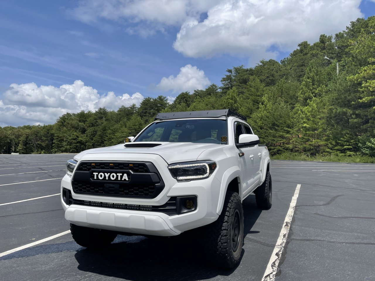

    Lawson
    2022 Tacoma Off-road edition
    Brand new.
    What brand of roof rack do you have?
  12. Jan 7, 2022 at 8:51 AM
    #32
    AwesomeLaw68
    AwesomeLaw68 Well-Known Member
    Nov 12, 2021
    #381936
    1,622
    Lawson
    Brand new.
    Lift Kits?
    what size wheels and tires and offset?

    Prinsu
